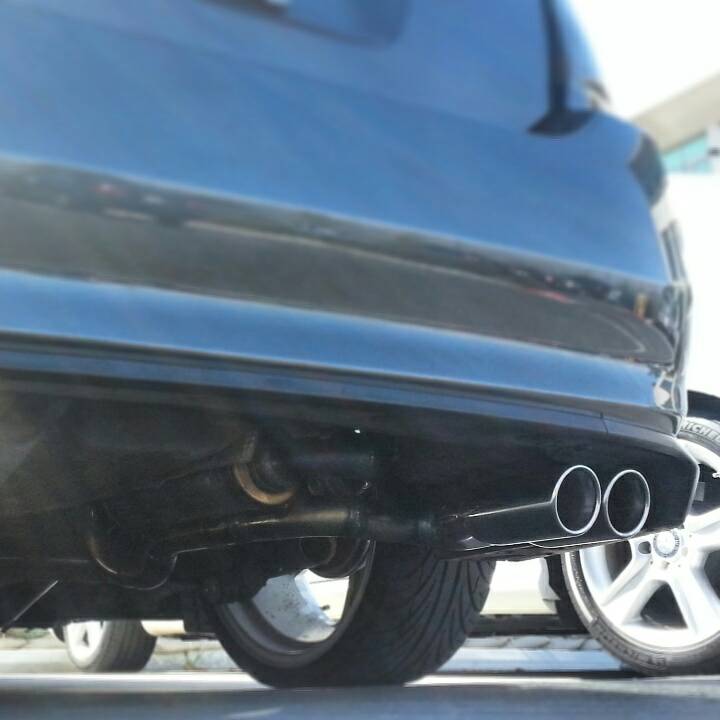

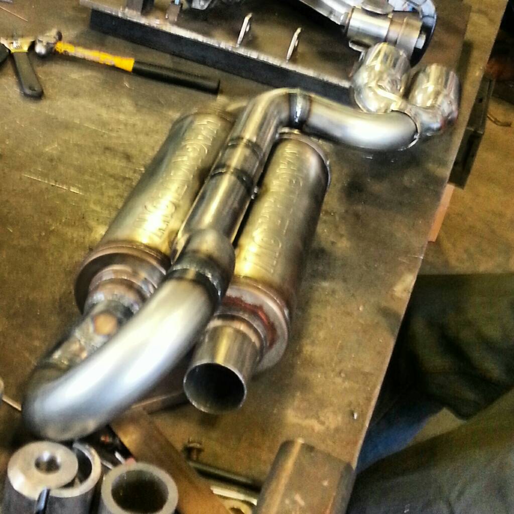

    Can't say I've ran the car on the dyno so no HP numbers to back up my butt-o-meter..and it wasn't really cheap.. but I love my DC Sports header, 2nd Cat delete and Custom MagnaFlow exhaust.

    I really like the way that looks, did it increase the sound at all? Because I am tempted to just get the Ganador exhaust from sigma

    Improved flow overall with my custom intake. Been said by a co-worker that it sounds throaty like a VQ engine but deeper. The hybrid battery charges up faster, no MPG update yet on my 2007 but it improved quite a bit with my 2008. Definitely feels quicker,but no dyno proof of course. Really feel like the OEM headers, the (2) cats, resonator and muffler as well as the reduced piping size really limited the "potential" of the little 1.5L.
    I can't single handedly prove it improved my MPG but I know with the combination of the custom intake AND the custom Header back exhaust i felt a performance increase when I flogged my car and I saw a mpg increase when I drove economical. Best run ever on stock exhaust with stock intake with OEM 16" wheels was 44mpg - I was getting constantly above 50mpg once I finished the entire exhaust setup.
    MPG depend largely on driving style, but also terrain and climate. In SoCal I was getting 41mpg with my 19s and now here in Canada I'm getting 40mpgish. During the winter which is a majority of the weather up here - I struggle to get 38mpg.

    Yup. Pretty cheap too. You can read about the issues and fun here: Prius Exhaust Mods? | Page 6 | PriusChat

    There are (4) 4" Magnaflow mufflers in total - cost about $65 ea ($260 for all 4), the header from THMotorsports for around $385. So with labor and material about $1000...roughly.
