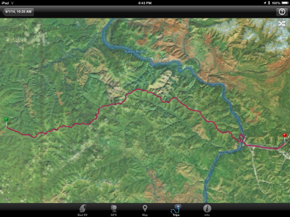

    Donut was at 40 psi but I had air pump and could inflate to 60 psi before installing on vehicle. Very worried about driving donut on very rough road, so was driving only 10-15 mph and dodging potholes for 30 miles to Dawson City, Yukon, Canada. Jack is flimsy and unstable on dirt road. Jack handle is flimsy and awkward to turn with tire completely flat as chassis is quite low to the ground. Would prefer full-sized spare.
