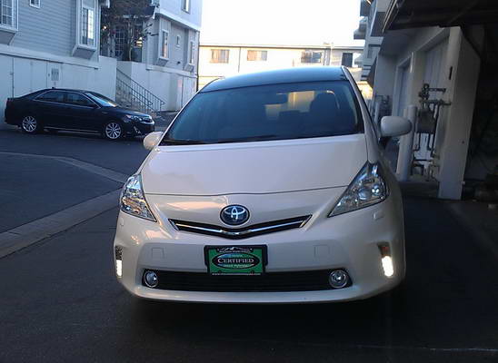

    You can try adding dual function fog lamps. (fog & DRL)
    Below is my Prius C w/ Varco fog lamp
    Outer are DRL and center part serves as fog lamp.

    Chris, how about a pic of the DRLs in bright sunlight? Still visible?

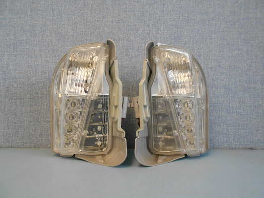

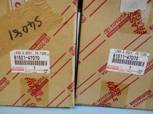

    That is quite a deal. I looked into these a year ago and they were over $400 each, from a UK breaker.
