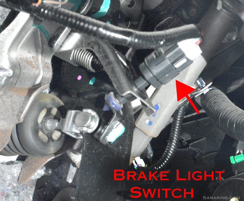

  12. robomoto
    robomoto Member
    Jul 18, 2018
    78
    56
    Surrey, BC, Canada
    I don't know about the energy monitor but my cruise control light did blink and turn itself off after a few minutes of being left on. I solved the problem by re-situating the brake light switch closer towards the pedal (push it into the pedal) and wiggling/tightening its electrical connector. As you can see, the switch unit has adjustable threads so you can turn it one way to free it loose from its bracket, then you can push it in deeper towards the pedal, then you turn it the other way to fix it in the new position. Something must have become slightly loose after years of driving.
    The pic below is not from the prius but it's similar. Just look under the dash.
    drbtz likes this.
