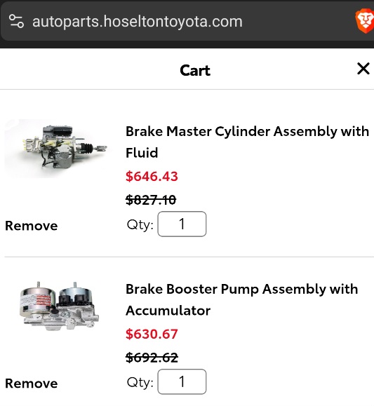

    A long story short, my Prius ended up back at the same dealership. They've had it a few days, but gave me a loaner this time, which was appreciated.
    They emailed me an update tonight, and it's not good at all.
    "The tech has recommended for the abs actuator to be replaced as it incorporates a lot of the systems associated with the codes hes getting. So in order to remove and replace that its 4 hrs labor @ $185 ($740) and the parts are $1013.70 so $1753.70 plus tax."
    There's no way I could possibly afford that, especially because my job security evaporated this week. :(
    I tried looking the parts up on RockAuto, but I don't think I'm looking at the correct ones. I think the only one over $140 is an Ignition Starter Switch.
    The following is more context, but probably superfluous. I try to provide as much info as possible, in case something I don't think is important enough to mention, is actually a necessary part of the puzzle.
    I take everything a dealership says with a heap of salt, but I do have a question. The tech mentioned after reviewing my DTC pdfs from over the course of this situation, some codes showed up only after the replacement repairs. It's possible that when the original shop replaced the hub assembly, and later the speed sensor, they may have caused a short that got us here. Truth be told, my roommate and I had independently shared that concern.
    Without getting too deep in the woods; after the hub was replaced, but the issue persisted, they suggested further work. This wouldn't be covered under their guarantee, since they said it wasn't necessarily related to the original issue. Usually they're okay with me asking questions, so I asked if a speed sensor is something that's normally replaced along with a hub assembly. They said they had no way of knowing the sensor was bad when originally diagnosing the issue, because the sensor is buried in grease. I don't know if that's a common issue, but unfortunately they didn't seem willing to explain it further, so at the time I let it go.
    I think I ended up paying around $250 for the sensor installation, but I don't have that bill on hand to double check. This is the bill for the original hub assembly job, though.
    I suppose it doesn't make a huge amount of difference at this stage, but do you think it's likely, or even possible for the original shop to cause the abs actuator to fail in this scenario? Or is it more likely just hitting the pothole sent this all in motion and the ABS imploding was inevitable?

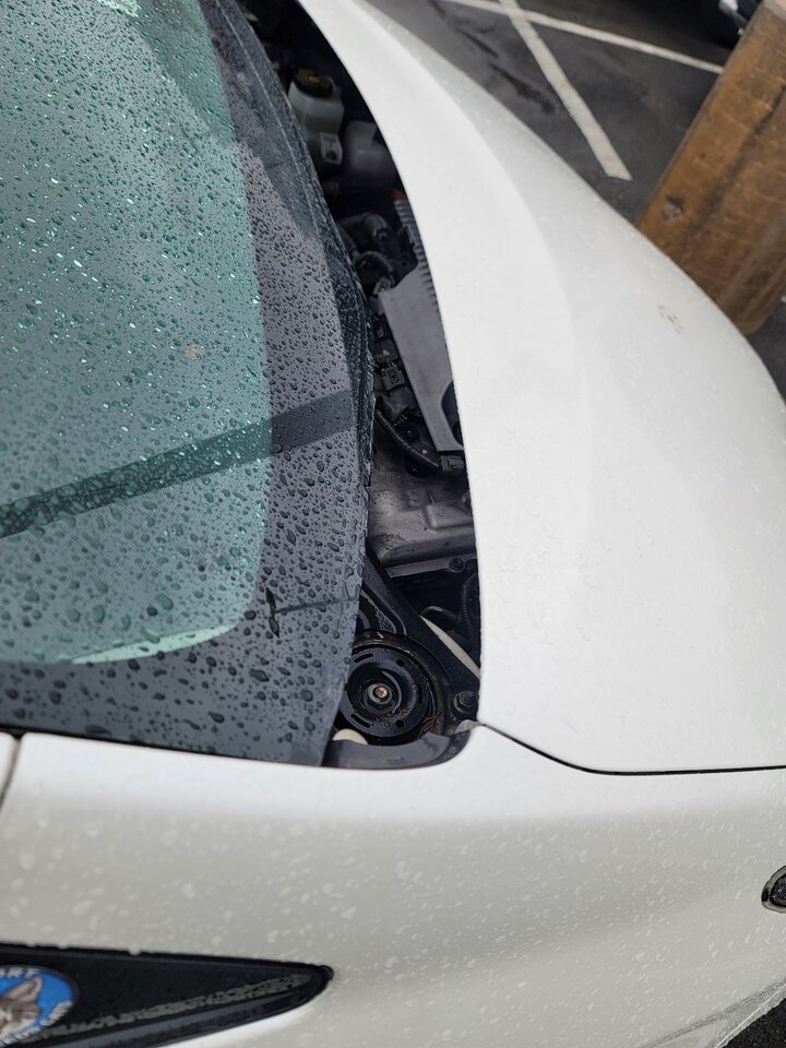

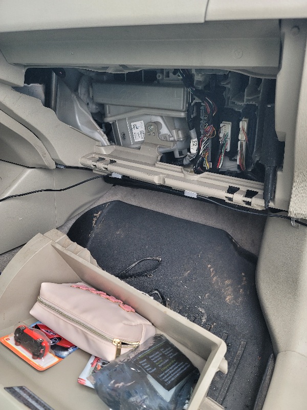

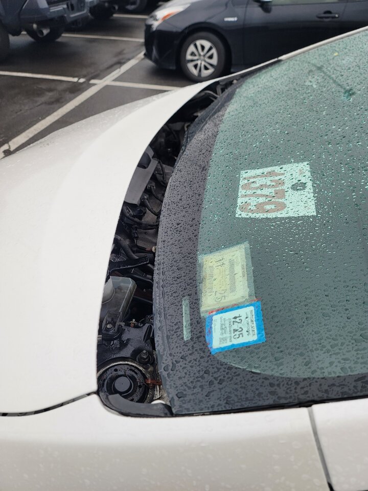

    I wanted to try out some of your suggestions, but my car's been at the dealership this entire time.
    They think it's these that need replacement, but they couldn't confirm it. (They never gave me the paperwork I asked for, so I'm not even sure how they came to that conclusion.)
    (It's not this specific dealership, I'm just showing the parts!)
    When they called to ask for me the loaner back, I told them not to do the repairs, and I'd take the back car instead. (I didn't directly say it, but I want to get it done elsewhere.)
    I couldn't bring it home the same day I returned the loaner, but they gave me my key so I could, even if they were closed. They had insisted on getting the loaner back that day, but since I was running behind for an appointment, I didn't think to check my car before leaving.
    Yesterday I drove the 40 minutes to get it (Sunday, so unfortunately they were closed). And. Uh. Here is how they left it for me.
    When I dropped it off with them, obviously it had a cowl, wipers, functional glovebox arm, etc. The missing parts are completely MIA. (I always said "stealership" in jest, but oof...) They honestly expected me to take it like this...:confused:
    Now I don't have the loaner, or my own car.
    So... I understand it's okay for some water to get in the engine bay, but it's been raining (often pouring), for days now... I didn't think to cover it somehow before leaving, because I cannot articulate how frustrated I was. Still unsure what do do, I left it there. How possibly screwed am I?
    I'll call Toyota directly tomorrow, although I'm not optimistic they'll give a hoot. (In over a decade of working with them, unfortunately they've not been very accommodating.)
    This sucks.:(

    You are missing a trough for the wipers and plastic covers. Of course, in the rain this can provoke much more subsequent problems with the failure of various systems due to water getting into the connectors and further corrosion.
    The glove box is held on by a couple of latches and its absence is not as scary now as the lack of protection between the hood and the windshield.
    The car should be parked indoors or under a protective cover.

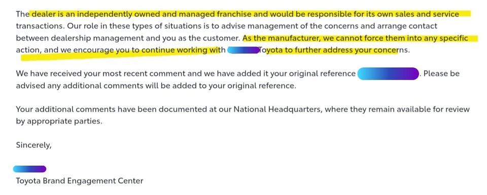

    Toyota says it doesn't make their certified dealerships take accountability for their actions, because they're only the manufacturer.
    It explains a lot though. This arrangement is probably an absolute perfect dream for a bad actor running a stealership.

    I suspect the dealership is telling Toyota Corp they previously diagnosed the brake booster and you refused. The reality is a brake booster failure is common on these cars and can cause many of the concerns.
    Unfortunately there are no aftermarket sources for that rather complex brake booster. The dealer does not see many 2010s because of their high labor rates.
    How did you determine the car is now worth $500? Is that what they offered as a trade in?
    I don't know how you would go "public". If you had a lawyer and good evidence, perhaps you could go that route. However most lawyers are expensive and the dealer can afford to counter with high dollar legal help.
    Sometimes it is time to find a newer car. The best value would be a conventional car rather than a hybrid.

    After several days of back and forth, Toyota Corporate told me both verbally and in writing that they're "just the manufacturing company", and they don't monitor the dealerships they certify, so if the dealership won't work with me, Toyota can't do anything. Then they entirely closed my case.

    The part pricing they gave you in the pic above was msrp. However you can get discounted prices through online Toyota dealers. I found $784 for master cylinder part number 04002-33447 as listed on the quote.
    During holiday specials the online dealer discounts are supplemented further by Toyota Corp. Last weekend during Labor Day was one of those extra discount periods where an additional 15% plus free shipping was available from some online Toyota dealers.
    You were quoted the Pump and the Master Cylinder. These days most get away with changing just the Master Cylinder. However the 2010's did have a batch of Pumps that failed, so it is reasonable the dealer quoted both. They have to guarantee the work and don't want to spend another four hours if they have to do the job again.
    It is a difficult time consuming project that is often frustrated when a diy'er can not calibrate it successfully.

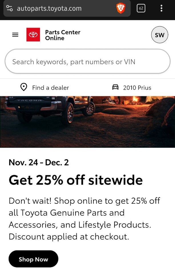

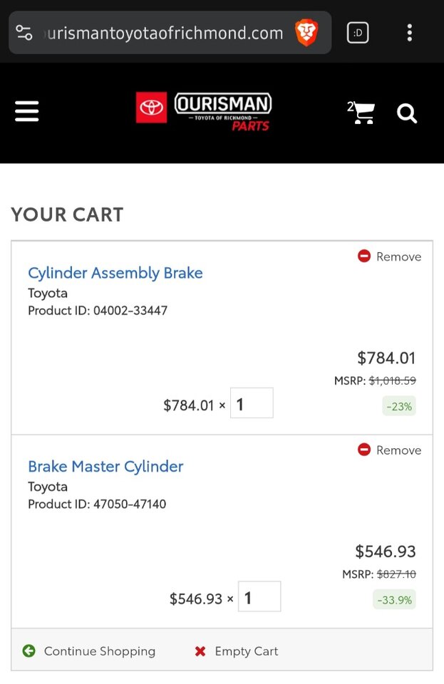

    Finally they're here, Toyota Black Friday discounts!
    :coffee:
    Are these the same thing with different part numbers? The one with pictures seems to look right?
    https://toyotaparts.ourismantoyotaofrichmond.com/oem-parts/toyota-brake-master-cylinder-4705047140
    https://toyotaparts.ourismantoyotaofrichmond.com/oem-parts/toyota-cylinder-assembly-brake-400233447
    I spoke with a local shop another Prius owner suggested. The shop agreed we should focus on the master cylinder first before going after the pump, just like you guys suggested. The install will cost around $300 if I provide the part.

    The smart move is to email them your cars vin and the screenshots of the parts you want and ask them to verify.
    Also ask if there is a tsb "kit" that has the needed part for less money.

    I asked about a kit too, and he's the response
    "47050-47140 is the factory part number for your vehicle. We do not see an applicable TSB for your vehicle."
    I kind of find this odd. From what I understand, this might apply, but is there a way for me to double check myself? http://www.nhtsa.gov doesn't give me results for applicable TSBs or CSPs on my exact VIN.

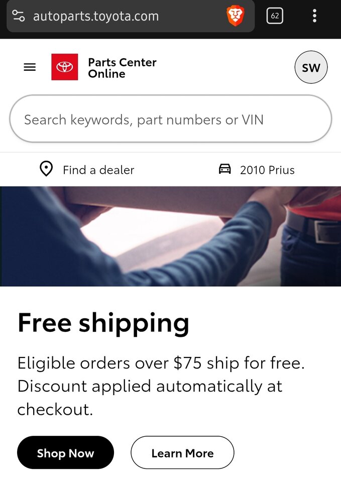

    EDIT: I can't get the free shipping promotion to work. I'm assuming it must be excluded because the fluid?
    Offer excludes products classified as hazardous materials (e.g., chemicals, compressed gases, etc.) and paints.
    This part is usually discounted around 30%, should the extra 25% apply on top? I couldn't get it to apply that either. :censored:
