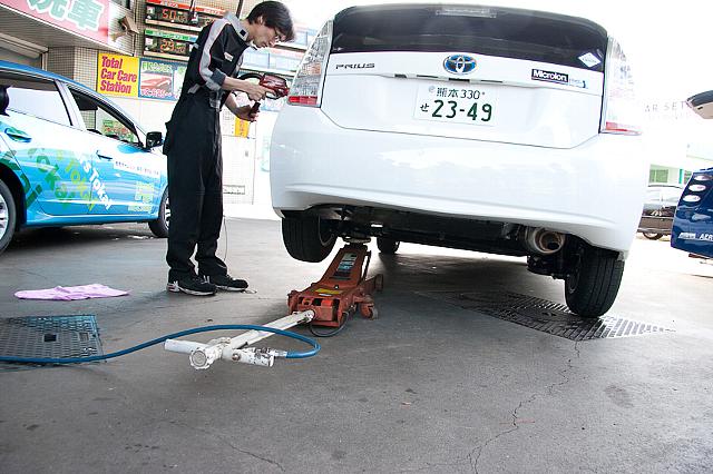

    I thought the Japanese hypermilers were getting about 60L in their GenII tanks, but don't recall whether or not those were the folks jacking up the corner of the cars to tilt the tank for maximum refills.
    Do the Euro market cars have different tanks than the Japanese domestic models?
    Edit: Not yet finding the photo of a car jacked up on the corner while refueling, but here is a relevant post, reply #5 of this thread -- about 50L level, or 60L when jacked up: Fuel tank capacity

  20. fuzzy1
    fuzzy1 Senior Member
    Feb 26, 2009
    17,312
    10,159
    Western Washington
    Yes, they were going for tank distance records:
    1,562 miles, New World Record with a single tank
    over 1,600 miles, Another World Record with a single tank
    New World Record - 1619 miles per tank
    New World Record - 1680 miles per tank
    New World Record Challenge: over 50km/L(117mpg) tank
    That last one ended at 118 MPG, and 1889 miles (3040 km) on a single tank of 60.16L.
    And I finally found that refueling picture in one of Ken's photo albums. This is how they get 60L refills:
