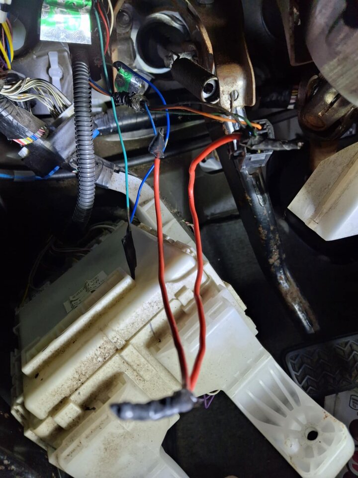

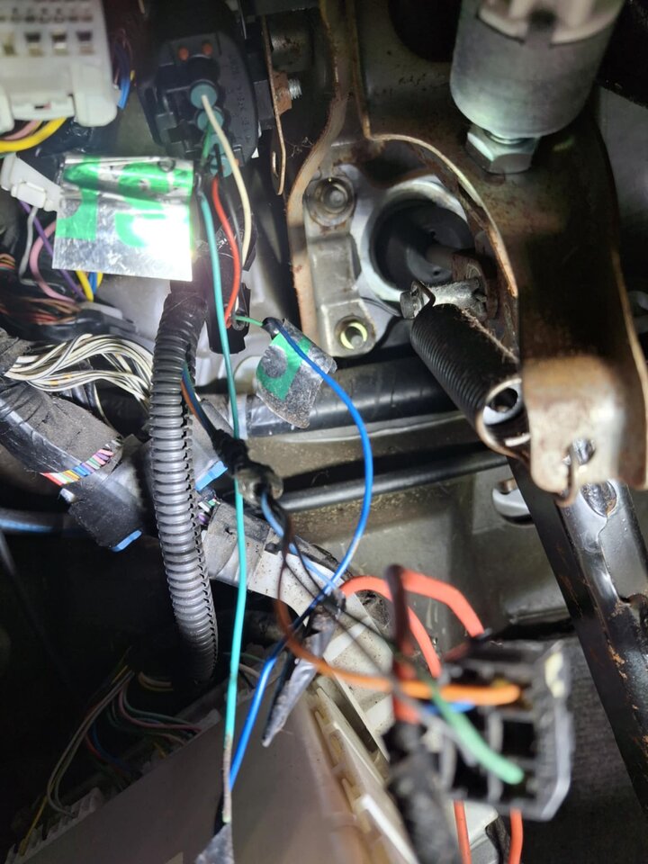

    Appears I found all the wire and am still wondering what the resistance and capacitance effects are on the digital signals if that's what those are for. Didn't ID the connectors and pins along with wire colors just yet. Only conductivity to see if open circuit or not. No voltage testing as well unfortunately.

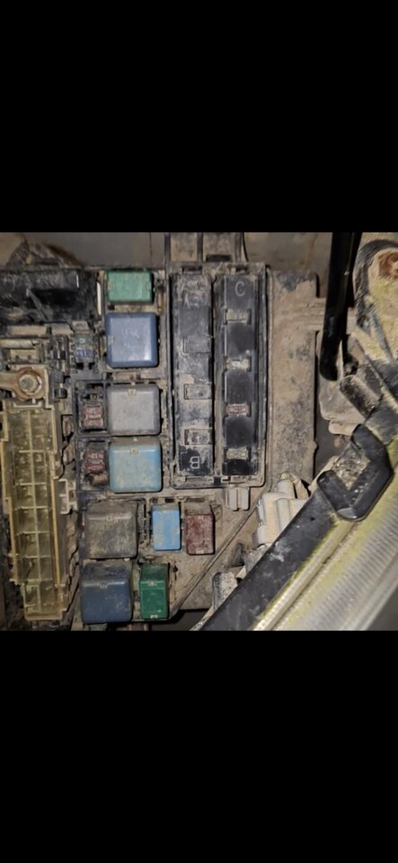

    I did come to the conclusion, since troubleshooting would be check not the wiring harness first, the fuse box and all the fuses need replacing. AM2 was not conductive nor were any of the fuses for that matter. AM2 also pulled out as a crumbled mess where I am guessing formic acid from the ants is to play? Whether that was a situation from the ants or issues prior or from the ants after sitting a year.
    48018291-4b3e-41c7-808d-c895fc9cc8a4.jpeg 81a80859-9b1c-4756-9cf9-fd75a853695c.jpeg 984ea976-29e8-432b-9865-c14cacd6a1c5.jpeg 812bfc5b-b25f-4cdb-b740-448c814d5270.jpeg
    Amazingly, performing the conductivity testing only as time was limited, everything appears to be conductive connections albeit solder blobs that are not that pretty.

    So I'm to believe those red wires were separated and device inserted in between so to speak.if that's so. Then up by pwr distro box should be another probably white wire it's Fat in same condition as red here?

    Boy that's ugly fuse box .

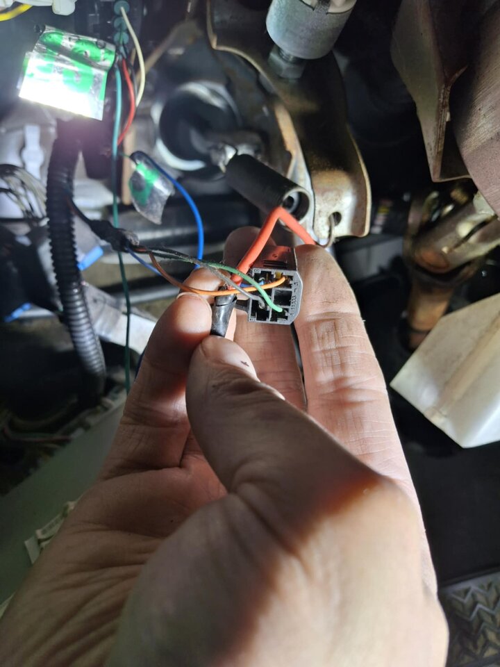

    Appears they spliced into the fat blue wires (11 1H and 1 1C) for switching PWR power and I guess HTR for power? At least I'm thinking if I'm reading correctly. (4 1J) was spliced as well, which appears to be the IGN ignition. Brake pedal was the blue wire and I still need to read what the green wire is going into, a tan-yellow thing. The green had the blue wires added and the blue had the red wires added.
    Appears the additional lengths of Blue wires and Red wires were for dropping down those circuits wires for easier access maybe later to more quickly remove or to run to the IID thingy. Those get me wondering if somehow they are adding additional resistance and or capacitance to cause digital signals to be wonky. Just random guessing, though seems like if worked with then probably logically not. Wondered if any of the mess of em jostled around before insulating if grounding could have blow a fuse or damaged something?
    Yes sir, amen to that. I should of taken a photo of the pulled fuse that crumbled into powder and the plastic piece more opaque than clear blue with no continuity even when pulled. Even in the yards and all the Priuses and vehicles I've pulled fuses out of, never witnessed anything like. Fumeric Acid from the ants is my best guess.

    So now you trim back the extension wires clean up connections and resistance change should be minimal.
  7. James Analytic
    Jun 14, 2019
    329
    51
    Michigan
    I agree and prefer to splice so no so goobery blobs of solder. Ordered more shrink tube, so can seal nicely as well.
    Wound up grabbing the fuse box at the yard and swapping in the C block section for starters since AM2 was toast.
    That and solder temp rigged the thermos engine water pump harness at the connector that might have been shorting out in the harness since as was found missing a few inch section with like 1" pigtail at the connector side. Still won't startup, i.e. go into ON (READY), however does go into the other two ON (ACC) and ON (IG) so was able to read codes. MFD and Dash came on as well.

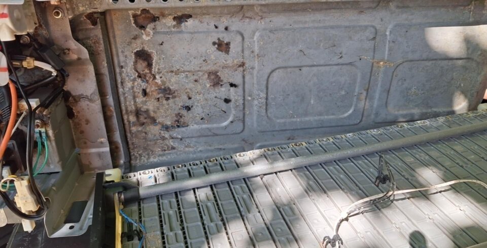

    Going into READY mode and moving, with some other issues I need to address, after HV battery swapped to replace this never in my life before seen mess:

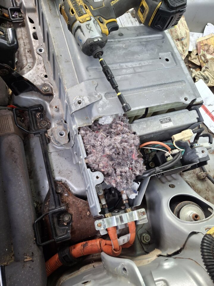

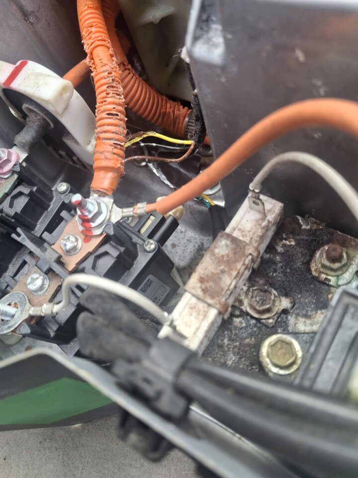

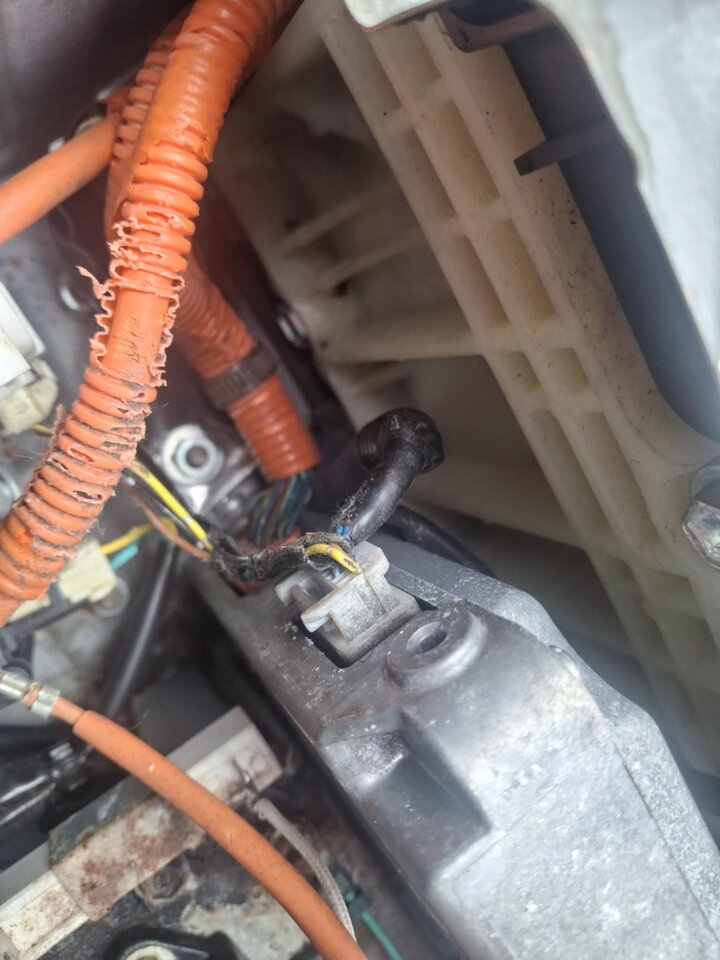

    That mod was removed and not well documented as of yet. Whomever engineered that knew to chew the sense wires of some sort, current I'm guessing as well as one of the temp. Thinking didn't want a mobile home. Stay tuned for further updates as I wonder if will be a unique HV battery wiring repair video, optimistically thinking ahead as the charge level on the MFD showed enough bars to start the car. Maybe current reading and not only temp reading was unsuitable?
    I did notice some lamp black above and wires chewed on. Didn't inspect enough to repair there since wanted to swap in a known working HV battery since in a rush to get it out from under the walnut trees and to someone who can use.

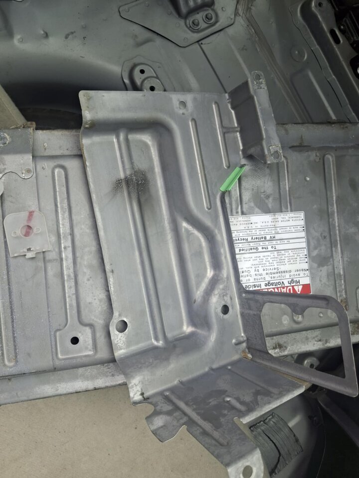

    Bummer, HV battery somehow discharged to ~114V. Thinking I might be motivated for the grid charger assembly as I have the parts required. Told the other half, assembling that might be a neat thing to do for a birthday task.
    Documented what I observed and will try to upload more when I can.
    Here's a teaser.
    3db371b2-20b4-4b92-8732-d3b958f6e5be.jpeg be58dc69-c433-4a8d-a7ab-c7b07089e8ec.jpeg dd807bf7-ece7-4a2b-bae6-549d7d6eacfa.jpeg

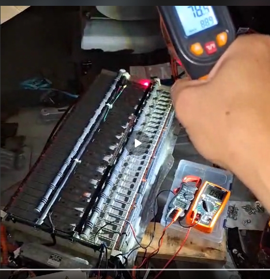

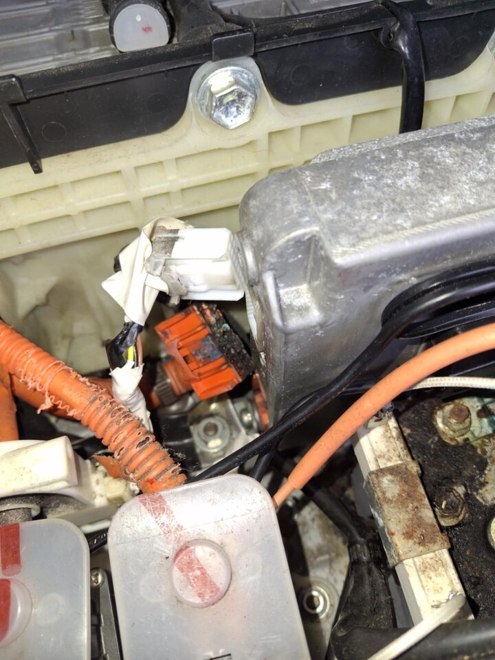

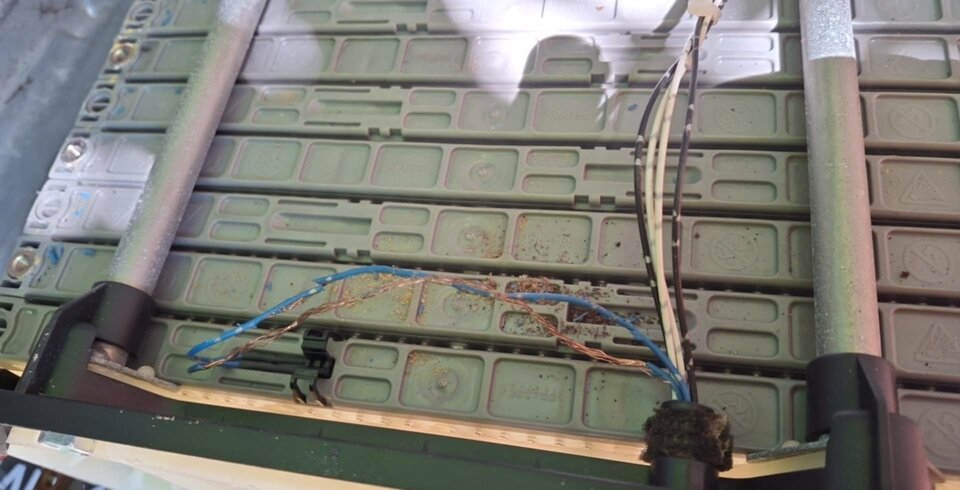

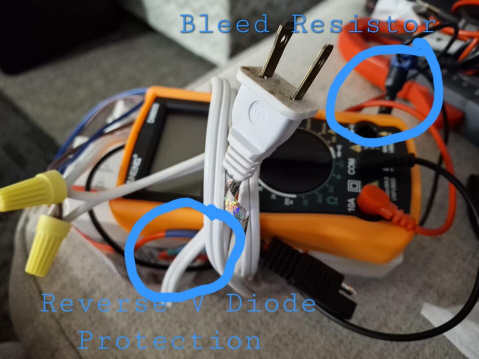

    Wound up assembling the grid charger and charging the original mouse nest HV pack after ghetto taping over the mouse chewed wires that seemed to still be conductive when inspected. I admit, I didn't conductivity check at the plugs after doing now that I am typing this and thinking about regarding.
    So, I'll copy and paste what I noted elsewhere:
    "From 114VDC as-found after cleaning and some small repairs. She decided to see how performs once recharged only (no reconditioning cycles like per the Prolong instructions and other NiMH pack methods). Took approx 12hrs to stabilize at ~235V and then let balance at that for ~10hrs. Block 12 was the only block that was consistently higher temp by no more than 10 degrees at any time (that was when fan battery died before plugging in the Bauer fan to 120V mains) and no specific modules cells stood out overheating which is a good thing. Block 12 temp never went above ~98, where the outside temp was maybe mid to high 80's. So seems like a good pack so far and the last owners did a good job replacing modules. She'll let Toyota and Dr. Prius / Dr. Hybrid app tell us what the performance is in more detail and if needed can disassemble and test more thoroughly. Otherwise will pack up and secure to spec for her."
    In regards to driving back to her place with a known good HV pack, I did find with no related codes other than the prior noted SKS and brake sensors seems. Wondering if the later might be a fuse in the ant's nest potential mess for the ABS. Will have to look for chews and opens.
    P0A9D, P0AFA, P3000 and P0AC0 came up after swapping back in the mouse nest HV pack that came with, since wanted to see what the ghetto inspection and taping to prevent shorts between wires might have done. Still the urinated mess of a system section where I am thinking I'll see what Live data looks like for the battery to get some more clues before removing the HV Battery Computer ECU and opening that up to check for corrosion since appears outside without a doubt next to the connector. I didn't inspect the Orange sense wires connections anywhere, so after Autel Live Data review I anticipate doing that and more swapping HV pack parts.

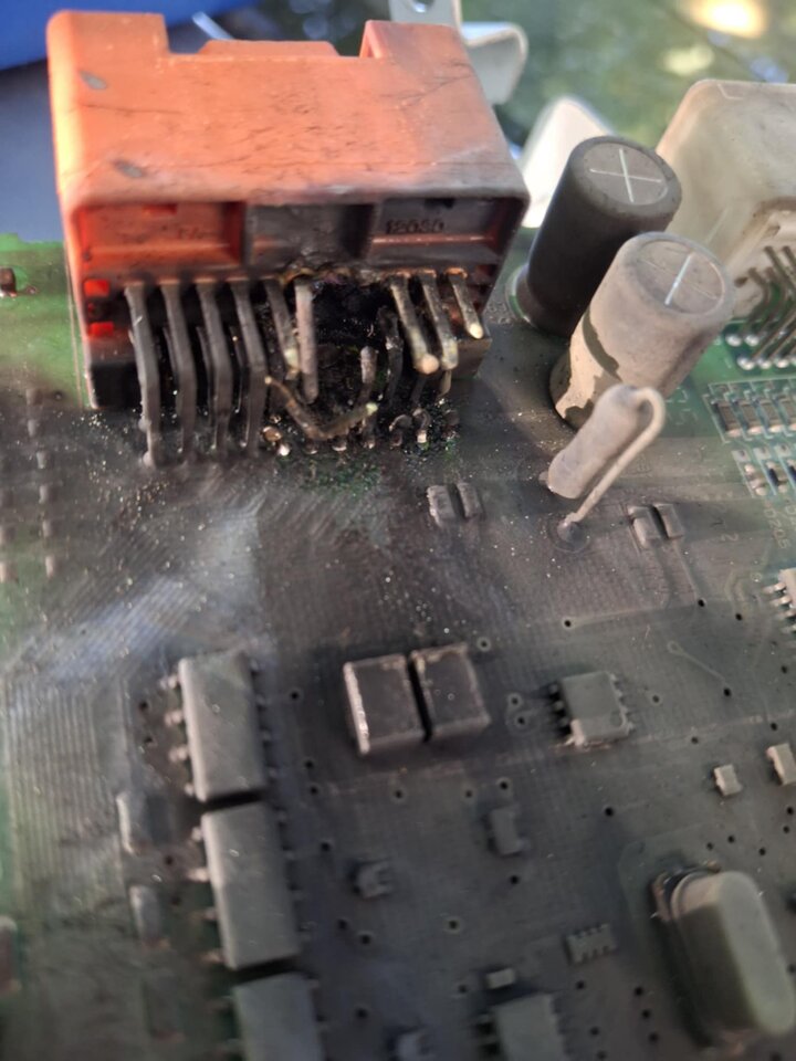

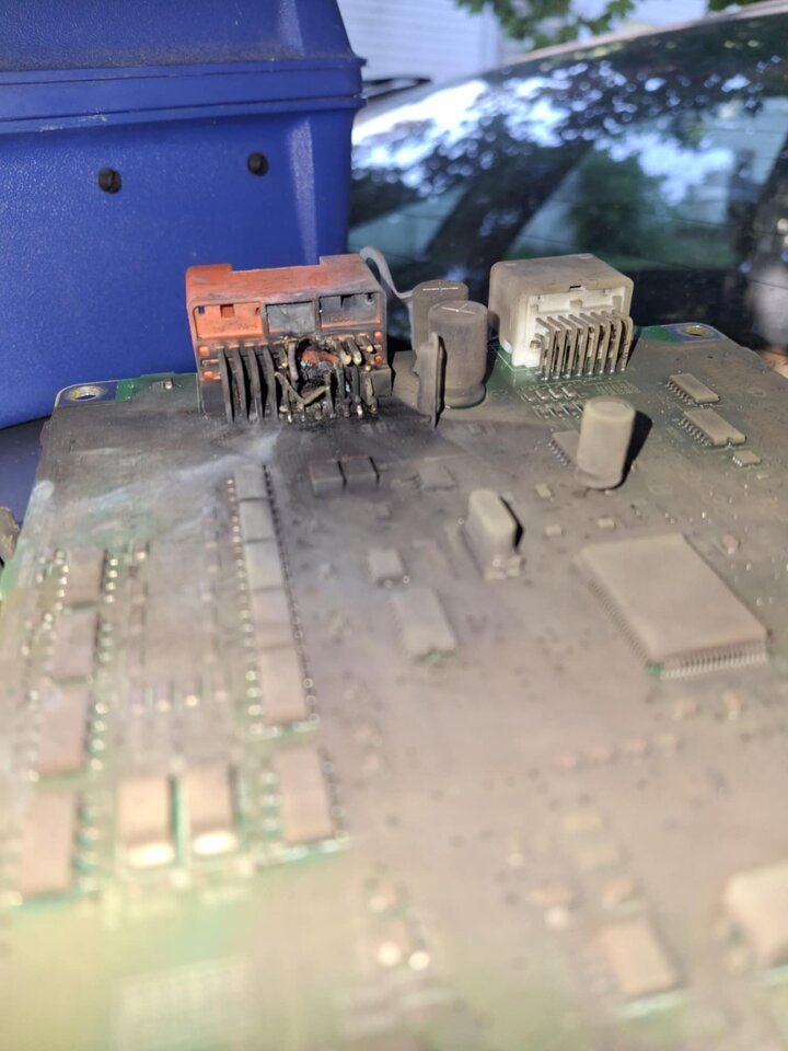

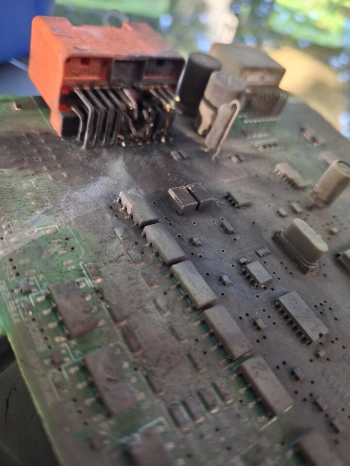

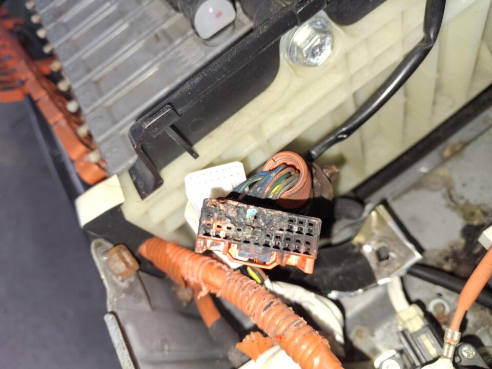

    Here is the post rainy day guessing humidity swelled something up just right in regards to electrolyte that was built up on the inside of the HV Battery Computer ECU sense wire harness connector. The days prior I had started the car up to open and close windows and one of the last things I did was read what the HV Battery ECU codes and situation from that end were prior to planning to pull since car was still performing and reading same as prior with the original battery. ***PSA - When An HV Battery Is That Nasty, Inspect Everything Thoroughly***

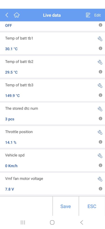

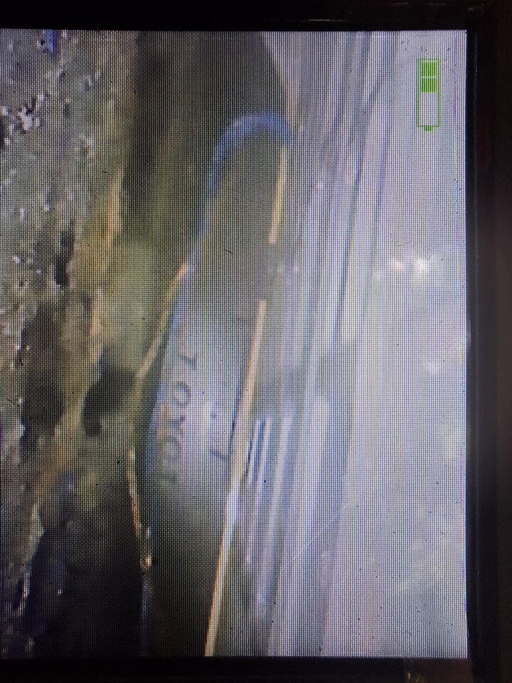

    Definitely correlates with the chewed wire Temp #3 Sensor that for some reason after borescope reviewing prior to disassembly, tests lowest resistant at ~9.45Kohms at the connector. The Temp #2 was ~9.90Kohms and Temp #1 was ~9.56Kohms. Intake Temp Sensor was ~9.35Kohms. Maybe I jostled #3 with the borescope into a more favorable position or the readings were amazingly correct and the HV Battery Computer ECU was already having issues from the prior observed whatever caused the lampblack on the cover situation.
    As we can see in the image above and below, prior to my 4th of July at the Orange Sense Wire Connection to the HV Battery ECU very brief Fireworks show, the sense wires were definitely not sensing correctly (confirmed prior to Grid Charging prior assembly was correct). Where again, from my observations with other corroded HV Battery Computer ECU modules, maybe there can be buildup of oxidation-corrosion on the inside part of the connector where I am guessing debris along with urine possibly can build up and on the humid day decide to spectacularly short? Strange since happened as I was unplugging the HV Battery ECU outside connection to the vehicle harness. FYI... every block past block 3 read wrong and no mouse chew marks were on the sense wire harness.
    b88f5a48-e999-433b-b848-1d08d907b20e.jpeg 3531a042-ed61-48ed-aeb5-3b83951f2872.jpeg

    Ow we going places that's the plug and receptacle im talking about . Ponscmust be gone in computer . Should be plentiful the whole box

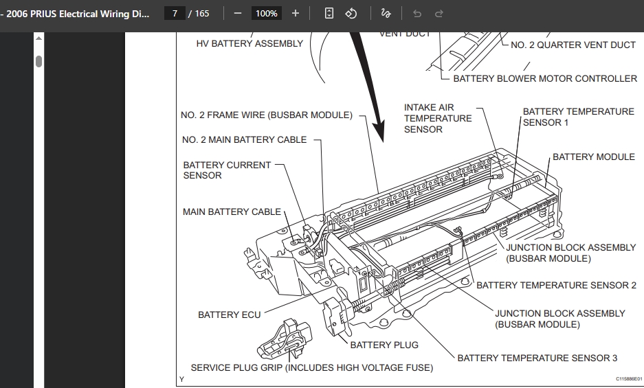

    Yes sir. Better close up photos of the temp #3 wire. Tests good actually, oddly enough.
    5996b2ed-22d0-4e42-a8fe-29ed435a7bbd.jpeg 662df982-819a-4466-99ca-e60293fe9fda.jpeg

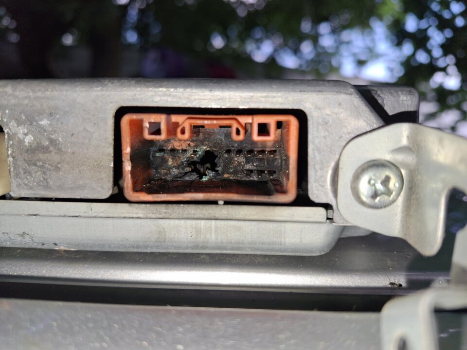

    I'm starting to realize this is turning into a sick porn thread. However, here is the last of the "I'm guessing why won't start" situation potential causes.
    I do see some green blue corrosion on the orange HV Battery ECU on the inside as I was suspecting. Starting to wonder is some sort of nitrate may have formed from the combination of urine and fecal matter over the year or who knows for how long. Wondering if the mouse can hear a high frequency arc as well from the beginnings of a bad connection or maybe smell and maybe they'd mark that?
    49de295e-420f-453d-bf22-f42dac776bed.jpeg 71189f12-3181-49fd-b4f2-288648eb866b.jpeg

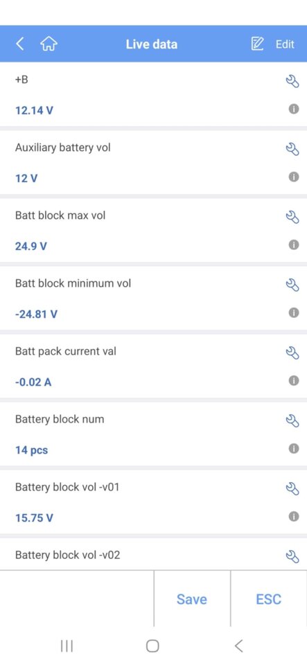

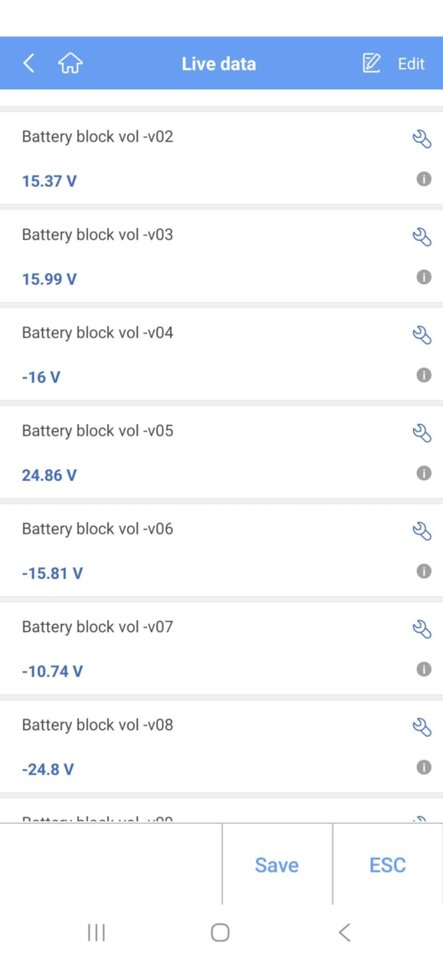

    Neat thing is I wound up today getting the HV Battery that came with back in service. Looks like I'm going to have one block low compared to the others that all seem considerable better for now. Does throw a P0A80 due to the voltage difference. However, neat IMO experience diving into and correcting most cost effectively and safely. Now to work on investigating the remaining codes causing incidents and correcting those situations.

    Yes, swapped in a good condition HV Battery ECU and No2 Frame Wire sense wire harness and now looks like after testing in the og car and the 08 I'm seeing I'm going to have to replace some modules since throwing a Block 7 code along with the P0A80. No biggy. ECU and sense wire harness cleared C1295, C1310, P0A9D, P0AFA and P3000 I think or the better 12V battery replaced did. On that topic, this Prius came with the second Prius AGM battery I've not been able to restore. I might zap with the FCAW welder and see if brings back to life, otherwise $10 core charge.
