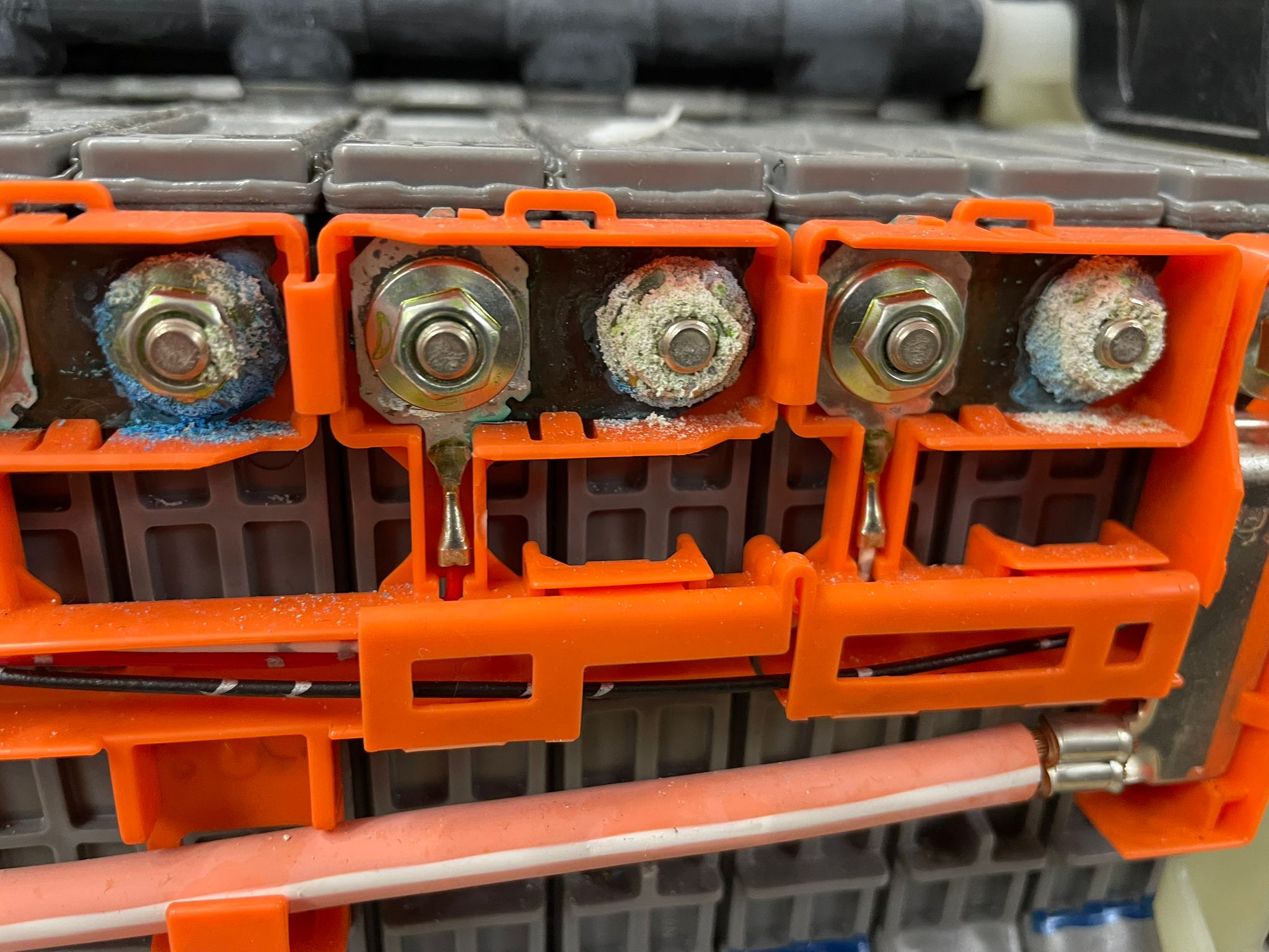

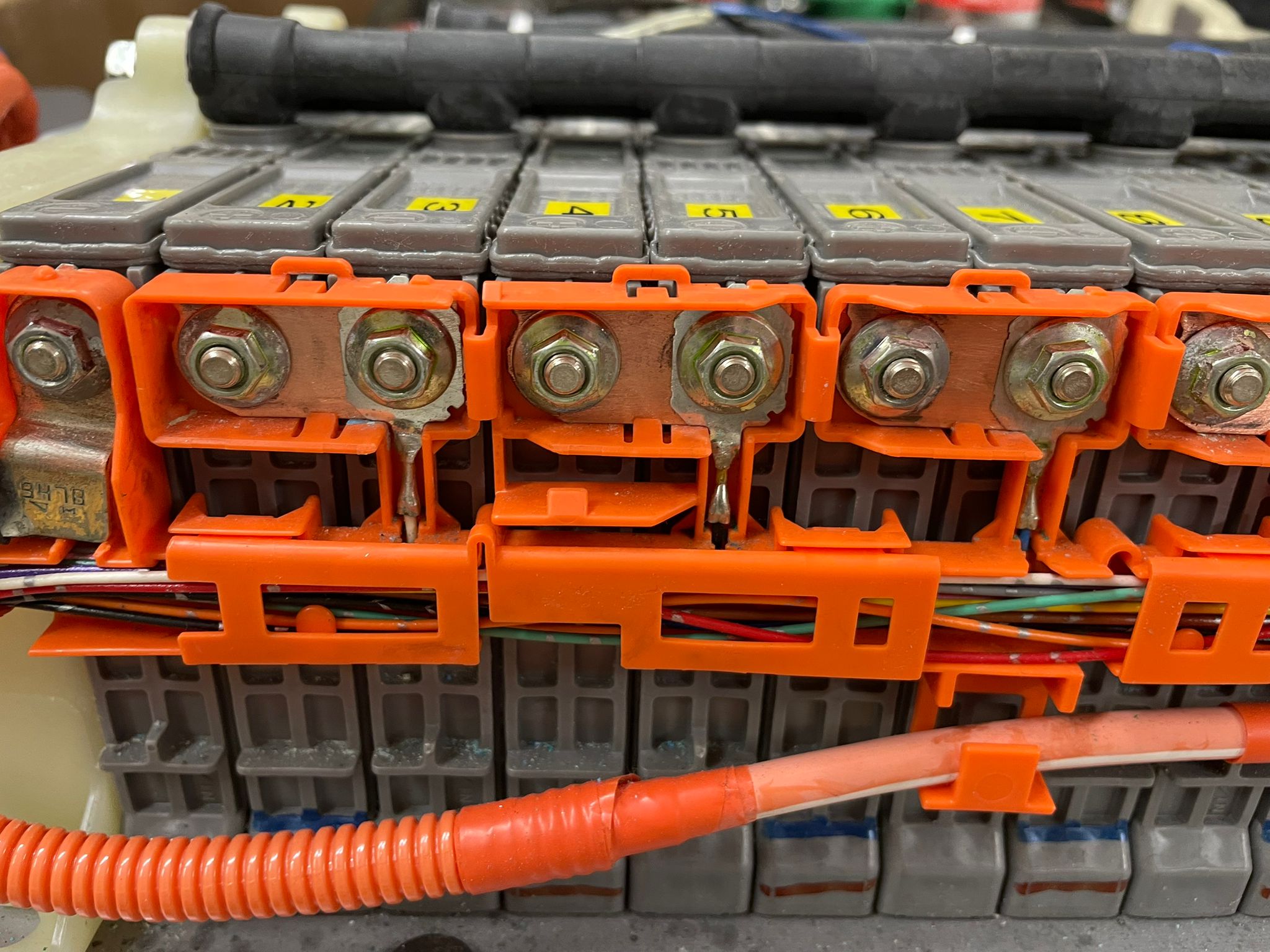

    Took the battery out today and picked it apart. First obvious thing was that the nuts were very corroded. I took all of them off and cleaned the busbar brackets on both sides.
    No corrosion has traveled up the wires and caused any damage.
    Will install the battery tomorrow and hope for no more trouble codes.
    Not a huge difference between any of the cells when I measured them. Removed the busbar and had the cells completely disconnected from one another when doing the measurement.

    You have leaking blocks..... That is not good....
