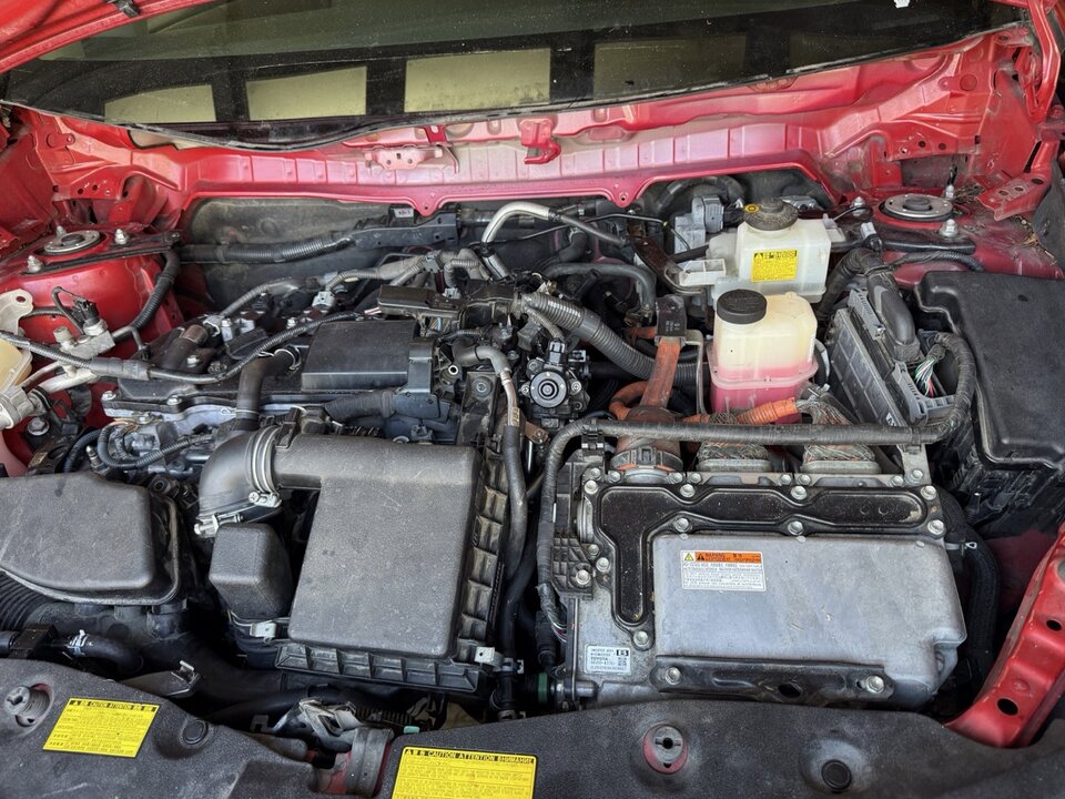

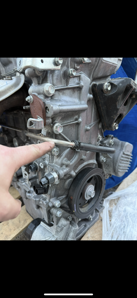

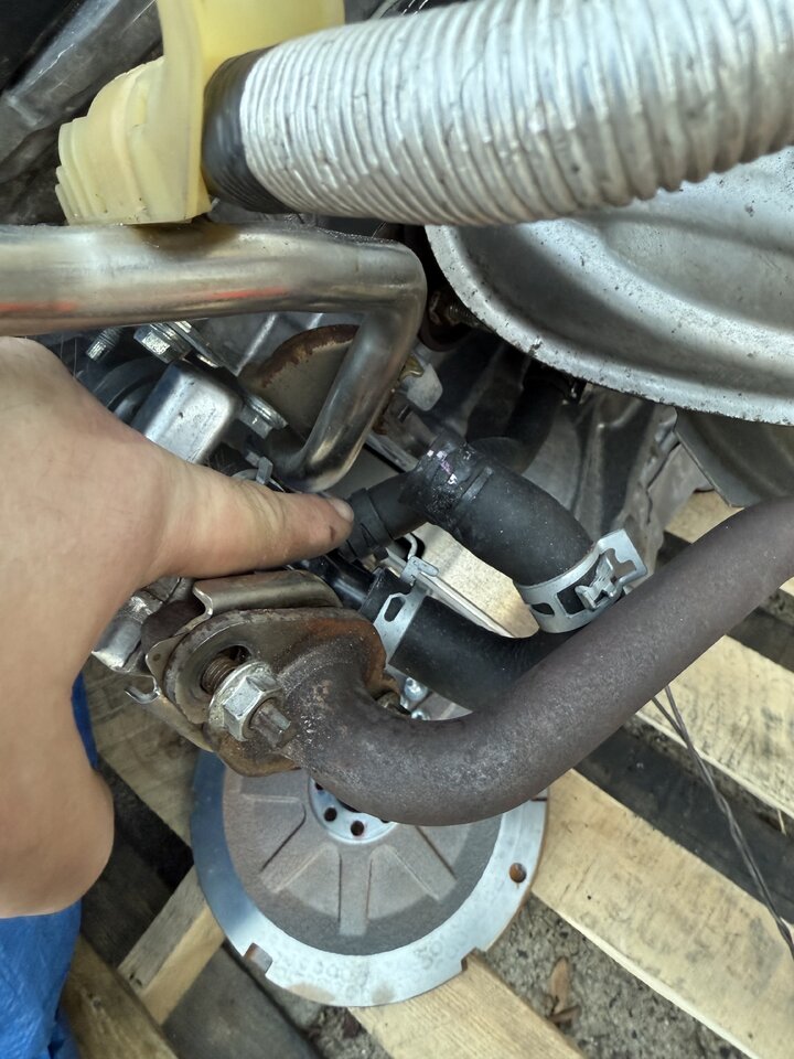

    What do I do with this hose?
    Head gasket blew on the 2012 Prius v and bent rods in #1 and #3. Found a 4th Gen engine to swap in.
    What do I do with this hose that isn’t present on the 3rd Gen timing cover? It runs under the exhaust manifold and to the revised coolant port.
    I’ve already swapped the exhaust manifold, flywheel, and engine mount, and test fit the 3rd gen EGR (with milling the head to remove the unneeded bracket).
  5. ChapmanF
    28,721
    19,019
    If I remember right, easiest thing is to plug the port in the timing cover, do away with the extra pipe and hose, and put a US-market water outlet on the rear of the head.

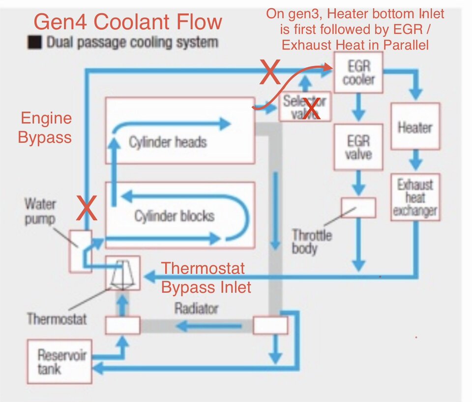

    I believe that is a gen4 coolant bypass direct to the egr cooler as shown below. Gen3 is different on the secondary flow.
    With a gen4 engine into a gen3, most eliminate the engine coolant bypass. You also won't have the selector valve.
    More detail on gen3 coolant flow
    See "Heater Coolant Flow" paragraph

  9. rjparker
    rjparker Tu Humilde Sirviente
    Jun 6, 2008
    11,097
    6,963
    Texas Hill Country
    Often the orange hv disconnect is not slid over after it was snapped closed. We have seen plenty of people who were sure it was right but it was not correctly engaged.
    Codes from Techstream or other full hybrid capable scanner may pinpoint a missing and hidden sensor connection.
    Brian1954, Mendel Leisk and SharkD like this.
  10. SharkD
    SharkD Junior Member
    Jun 17, 2019
    17
    Durham, NC, USA
    2015 Prius v wagon
    Thank you -- it was the HV battery disconnect being slid 90% but not all the way.
    The engine started, stumbled for 10 seconds with some harmonic balancer rattles, then smoothed out. I've bled the cooling system and feel ready for a road test.

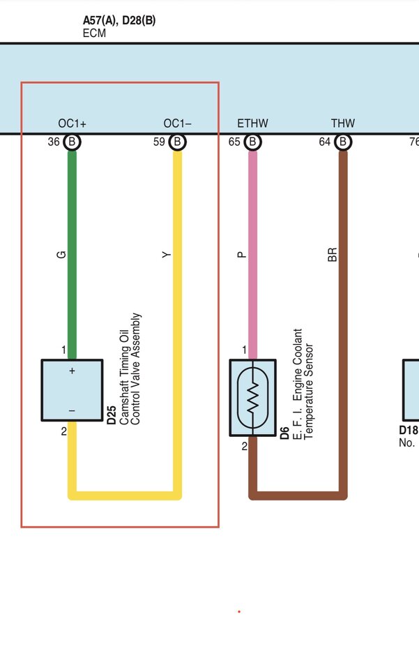

    P0010 is an open or short on the variable valve timing solenoid (camshaft timing oil control). Open could mean it's not pushed on enough or has something jamming it. Unlikely would be the solenoid is internally open. An ohm meter could check that and wiring to the ecm.
    Short means one of the wires is shorted to ground. Ohm meter again.
    It is a 2 wire device - not the three wire crankshaft position sensor.

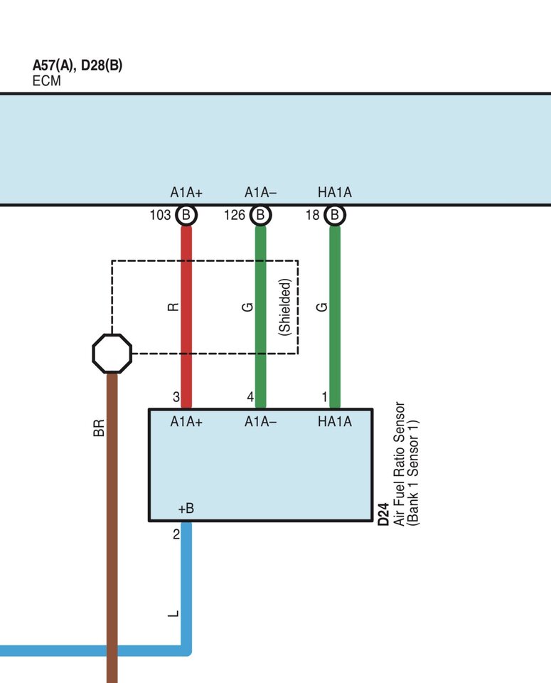

    Now, I have to resolve a P2238 and P2252 -- these popped up right as the headgasket was failing, so I think I need a new upstream O2 sensor.

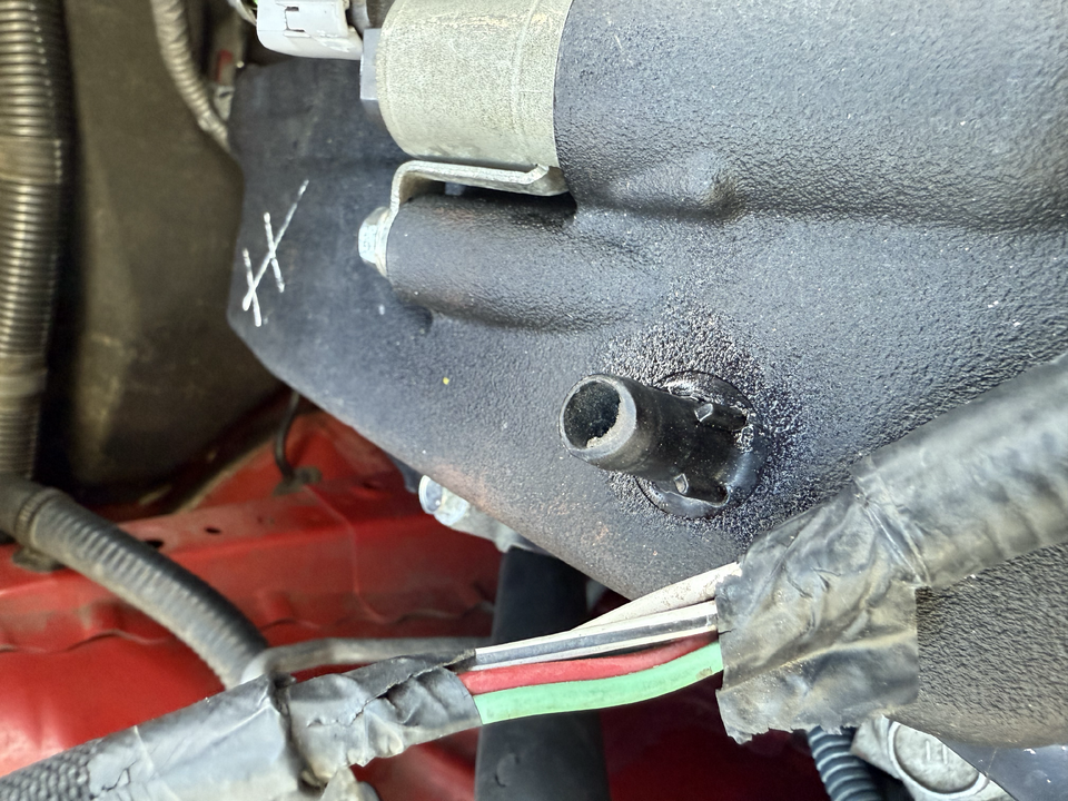

    Last question: does this need to be capped? (I assume it's a CCV -- there was electrical tape on it when the engine arrived.)
  13. rjparker
    Jun 6, 2008
    11,097
    6,963
    Texas Hill Country
    Odds are you have more wiring / connector issues with your air fuel sensor upstream of the cat.
    Not sure about the open port but if its the PCV (positive crankcase ventilation) system, you need it properly plumbed, not capped. Which is true if its anything else for that matter.
