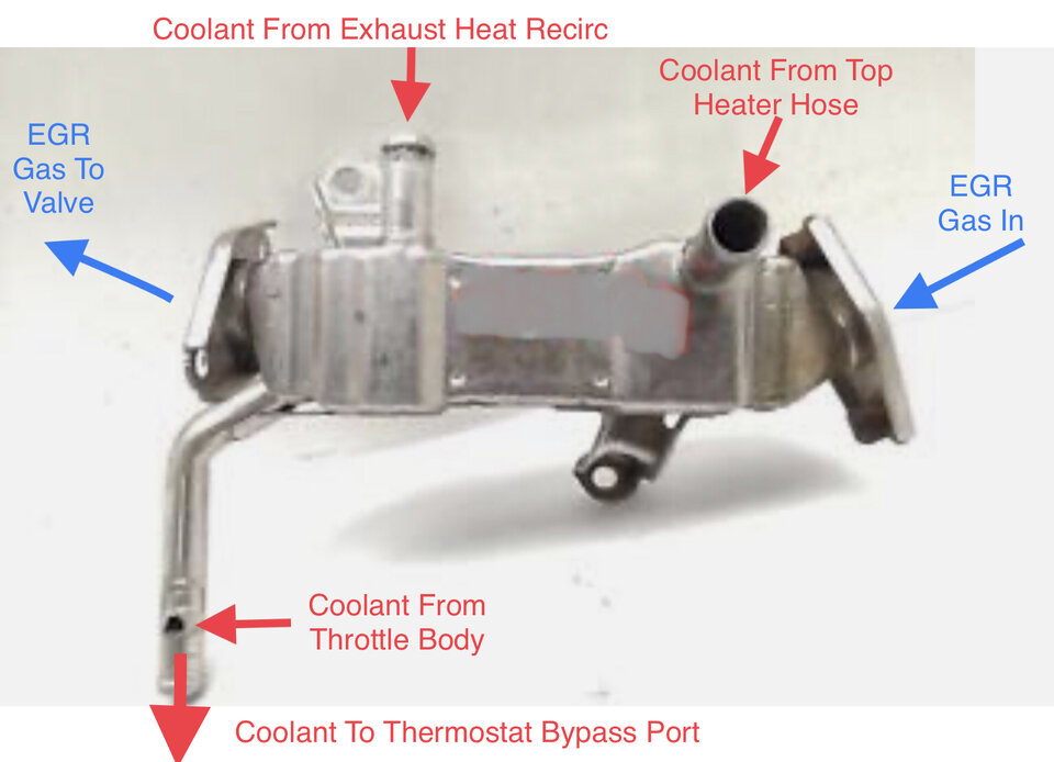

    Heater Coolant Flow
    Heater coolant flow is continuous and has no valves in its path. The "air mix" blend door opens to allow interior cabin flow through the heater core.
    The engine's big hose coolant flow is separate from the heater-> egr cooler/exhaust recirc -> thermostat bypass flow.
    The heater coolant flow enters the core through the bottom hose and exits through the top.
    After leaving the heater core it takes two paths, one through the egr cooler and a second parallel path through the exhaust heat recirculation system.
    Those two flows merge at the front of the egr cooler and return to the small thermostat bypass inlet which is designed to be open all the time.
    From the thermostat it goes to the water pump and then through the engine.
    From the engine it returns to the heater core's bottom hose.
