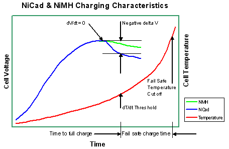

    What do you mean by charging to delta v?
    I mean whenever you charge it, you try to charge it fully to balance all the cells inside the module not necessarily delta v(?).

    "Delta V" is the sudden rise in voltage that occurs as each cell reaches fully charged. The charger can detect this change in voltage and stop the charging process so as to not overcharge the battery. One problem is detecting Delta V with a low charging current can be difficult. The other problem is that if the cells in a module are unbalanced, Delta V happens at different times for each cell.

    I should have been more careful with my terminology, I meant negative delta V. On my own bench my software detects a drop in voltage and terminates the charge by detecting a small drop in pack voltage after it peaks, I only do this when reconditioning packs. When it comes to testing you don't want to start with a fully charged module, weak cells tend to hold a lot more energy fresh off the charger than after a rest period. It's simply a matter of putting in a measured amount of energy into the pack and measuring how much energy you get out, hobby chargers do that, get one that logs/graphs for a much better understanding of what's going on. Start with a cooled down module (1-2 day rest), discharge down to 6v (4.8 is too low), then put in 6000mah charge and discharge down to 6v again, repeat x3. Repeat for every module and write down the results, all the modules should perform equally, with a slight deviation. Modules that are 10% or more off your average tend to be the ones that will fail next.
