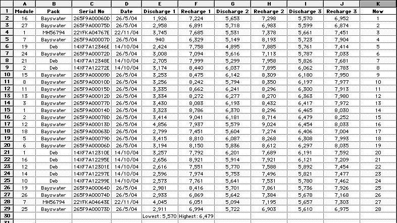

    I’ve got a P0AA6 error.
    I rebuilt this back in April. I combined the best modules from three different 2004 battery packs.
    I cycled the modules on a Turnigy Reaktor. I found the capacities to be hard to believe (ie some were showing almost-new levels), but went ahead and the battery worked fine in the car until a few days ago.
    This battery has worked extremely well until a few days ago, when I got the dreaded red triangle. A check with Techstream showed a P0AA6 error, along with 526 and 612 sub-codes (which indicate that the fault is within the hybrid battery).
    However, I also got a P0A37 code, which indicates a fault within the transmission. The fluid in that is Gulf Western Syn-TS, which has been approved for use in Toyota CVT transmissions (I rang Gulf Western to clarify).
    I’ve removed the hybrid battery and pulled it apart, expecting to see an obvious electrolyte leak somewhere.
    The nickel-plated busbars that I used all look like they’re still brand new. Zero corrosion. At the time I tightened each busbar nut (stainless steel) to 5.4Nm (48 in.lbs) with a torque wrench.
    There’s corrosion in the bottom of the tray, but I can’t remember if that was there before I rebuilt the battery (it was one of my first rebuilds).
    I’ve had a look at each individual module and can’t find any signs of liquid leakage.
    For now I’ve put the modules back on the Turnigy Reaktors to cycle again and measure the capacities.
    I had expected to see fluid leakage from a module, replace that module with a suitable one and consider the problem solved.
    But, without any signs of fluid leakage, how do I troubleshoot this?
