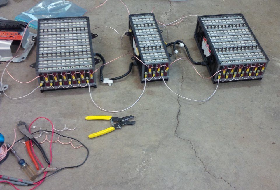

    Nice to know because after cycling my modules they all seemed to be able to hold capacity well (none less than 6,100 mAh) and they were well balanced for 24 hours (see balancing pic) but when I installed the packs again I got the same "weak bank 1" error I did before so I must have missed something. I wish I knew how the banks were counted on mine so I could narrow down which 2 modules were in question, but no one seems to have figured this out yet (please post if you do). Anyway I figured there must be an issue that only shows up when loading the modules since the capacities all seemed to test fine. I'm going to pull out the packs again and load test the modules individually to see if I find any with possible issues. I'll start by creating a 65W (high beam) headlight harness with a wall switch and multimeter to read voltage drops as you have to hopefully ferret out the bad one.
    On the bright side at least I had the smarts not to put the interior back in before I verified everything was working. :D
    Attached is a pic of balancing the packs........be careful of those leads or you'll be welding. ;)
