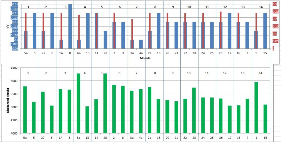

    I did. I used a 42W bulb and measured the voltage before and the voltage after 1 minute. I'm beginning to think that the load wasn't large enough or long enough.
    Below is the battery AFTER the rebuild. The blue bars are the module delta-volt (left-axis), the red bar is the block delta-volt (right axis)... which is the sum of the two delta-volts in the block. My goal was to get the sum of the pair about equal to the rest. The chart below that one is the capacity based on discharged mAH from the hobby chargers. I noticed that Block 4 and 5 (the trouble blocks throwing ECU codes) also have a big difference in terms of capacity. I paired that that way so it wouldn't throw a code. However, looks like I need to either replace 6A and 28 with weaker modules or replace 13 and 14 with stronger ones? What do you all advise?

    That load test wasn't nearly big enough, I would use a headlight with 65w high and 55w low (120w combined) and wire both on at once and hold it for at least a minute.
    Post your results again after that.

    The best way to check the internal resistance of the modules really requires an amp meter and a voltmeter. Attach the volt meter across the module under test "note the voltage" Load the module with your lamp in series with the amp meter "note the amps drawn and the voltage. Subtract the second voltage from the first voltage and divide by the amps. This should give a figure of around o.o24 ohms depending on how good the module is. The lower the better.
    EG 1st voltage 7.6 - second voltage 7.5 = 0.1 divided by the current 4 amps = 0.025 ohms
