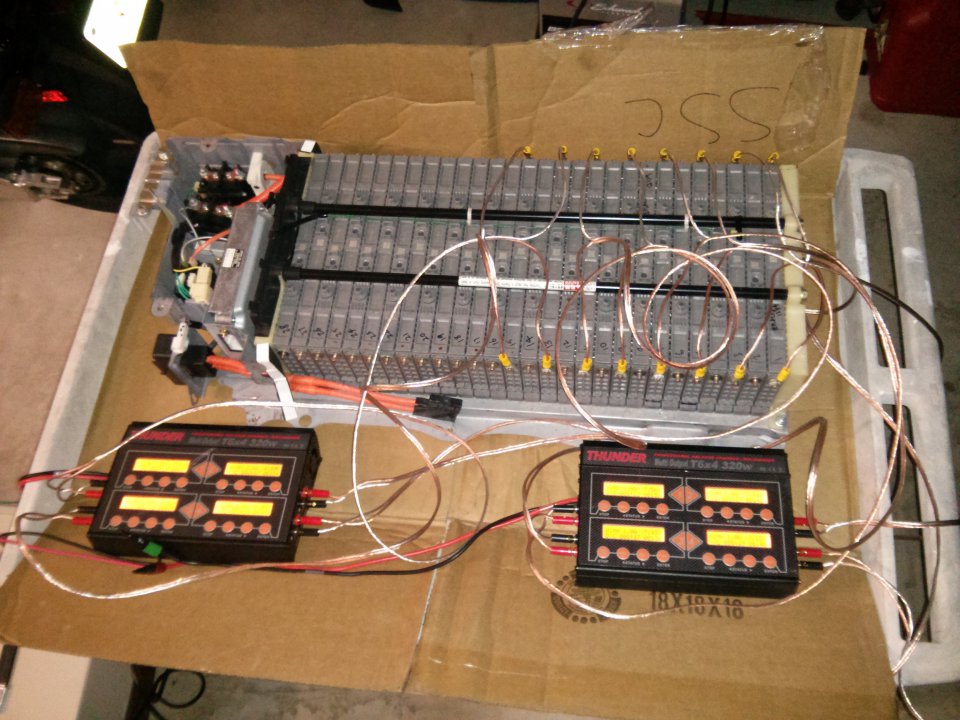

    Hello all,
    first post. First of all, thank you to all who have done the groundwork and shared their findings. It certainly makes things much easier for those of who come after.
    I am working on a 2005 Prius with about 160k miles that had P0A80 and P3000 codes. Followed info here to load test modules and found 2 that failed (#1 and #8 counting from opposite ECU end)
    Followed instructions per above for 2 THunder T6 chargers. I have them hooked up to 2 12V power supplies that can go up to 10A each.
    At first I was using little alligator clips, but was not getting good results on the mAh numbers, so I made up the leads as suggested in this thread with 14 ga. speaker wire, ring terminals and banana plugs. I didn't get much improvement.
    I'm attaching my data sheet. The modules that have been cycled 6 times are the ones that I re-cycled after improving my wire leads.
    I would appreciate your comments. suggestions, ideas? THank you!
    THe modules that have no listed data yet are currently on the charger (Man, this takes a long time!)
    I'm also attaching a couples pics of my charging/ IMG_20141223_234221.jpg IMG_20141223_234207.jpg
    I guess my main concern is the low numbers for discharge, and the fact that the chargers stop charging long before the 7000mAh cutoff.
    I used the exact settings as above.

    With that milage I would be very much surprised if your efforts would lead to any improvements. Please have a look at the load test of 2009 pack with that same mileage - from my opinion - too bad to justify working on it. Capacity is very low and pack it too much unbalanced. In that case load test took only 46 minutes. Contrary to widespread myths and even some US based patent personally I and our local battery gurus do not consider multiple charge/discharge cycles to be of any substantial use to the old tyred NiMH battery like yours - almost 10 years and 160K miles is the end of its life.

    Do not set the delta v cutoff when charging the modules set a maximum time limit. There can be 6 separate delta v peaks "one for each cell" so the first cell to reach full charge can turn off the charger before the other cells have caught up. Bear in mind that the charge efficiency of NiMh is only about 66%.

    I have actually finished this car and so far it seems to be a success. I ended up running 6 cycles on all of the modules but they still didn't all reach the 7000mAh. I never read anywhere to not set a delta v cutoff, instead the instructions clearly said to set delta v cutoff to 7000mAh and not set a time limit.

    The 6 individual cells in the module all have a delta v. With the cells being at different states of charge it would be a miracle for them all to reach the delta v point at the same time. Each will give a small rise in voltage and then fall as it reaches full charge "the so called knee point, delta v" triggering shutdown of the charging early when the first cell "the one with the highest charge" reaches that point. This is the likely reason why the input charge never reached 7000 ma.
    The idea of setting a charge of 7000 ma is for the charger to cut off at that point so that there is a slight overcharge on each cell in the module. This is something the cells can handle without damage providing the charge rate is not to high causing overheating. If 7000 ma is not put into the cells you cannot expect to get 6500 ma out particularly as the charge efficiency is only in the region of 66%. A charge of 7000 ma into a fully discharged cell would give an expected output of 4600 ma.
    This is the reason you needed to do 6 cycles on your modules, and still did not get the anticipated capacity.
