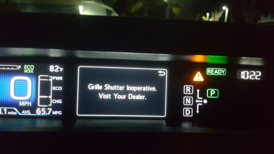

    Didn't know what to make of this message on the display initially. Took a look at the grille and found a 1" rock wedged in there, keeping it from opening fully. Once dislodged, all's well
    Engine code P05A0 reset with Carista

    I meant an actual message. Here is an image from the gen 4.
    from Grille shutter Inoperative | PriusChat
  20. vvillovv

    Is that a gen4 or prime dash? I noticed the plus has a different dash set than John1701a's advanced
    <a href="Winter driving too cold weather MPG down | PriusChat">Winter driving too cold weather MPG down</a>
    I haven't been able to find either that CHG/ECO/PWR below the 82 F (in the picture above) screen on my dash
    In John's video I linked to that space is different 0 10 20 under the 7 F ( I can't find that one either in our plus )
