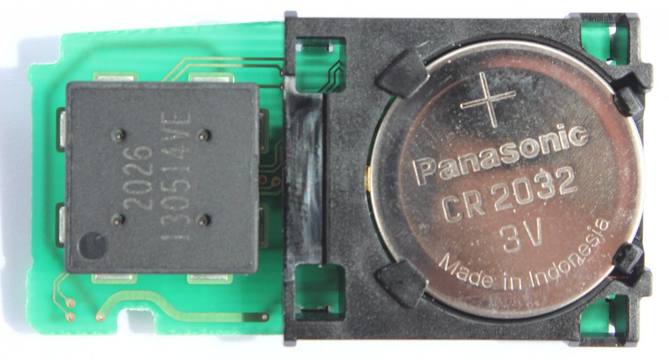

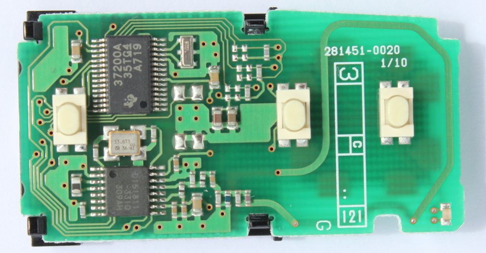

    I am interested in the having a regular key for my Smart Key system. This would be a key where you would use the mechanical blade in the door of the car to open the car, then to turn the car to READY, you would hold the head of they key up to the POWER switch so the car could read the transponder value and turn on. Similar the older car keys with a transponder in the plastic head, but using the metal blade to turn the mechanical lock.
    For instance I have taken the battery out of my SMART Key and have opened the car with the emergency key, then held the remote up to the POWER switch and then car would come on and operate. Yes, I realize this would cut down on convenience, but would allow a key to be carried in harsh environments with little risk of damage.
    To make this work, a key would have to have the same transponder in the head of the key as in our smart remote. Does anyone know what type of immobilizer system is in the Prius C3?
    Looking at the chips on the Smart Key didn't tell me much.

    The visit to the locksmith did not work. He could not find a key that would have a compatible transponder in it. He did manage to program a new key fob for my car, but it is just like the original SMART key fob. LOCKSMITHY if you know of a mechanical key with a transponder that the Prius C would accept, let me know.

    Im working with an engineer to make a simple chip key that will start car.
    All smart keys from all car makes have a backup RFID chip built into the key. This is the chip that needs to be copied.
    I have the blank chips in my shop...the problem is I haven't been able to crack the encryption on 80bit+ for 2010+ prius. Once encryption cracked..I will be able to transfer data onto a regular key like OP posted.
