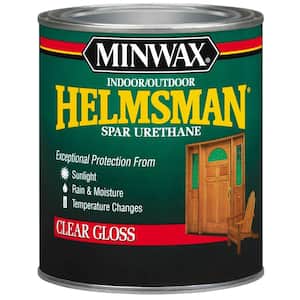

    I found a post somewhere that recommend using Helmsman spar urethane to clear coat the lens after polishing. I've tried it on my truck lights and on a clear plastic cover on a display that lives outside on a 4-wheeler. Time will tell how it holds up...
