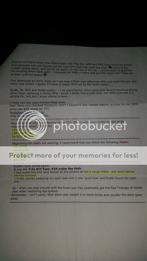

    Hey Freedom, did you end up checking the fuse? If the dealership said that they've never seen this issue I doubt even they checked the fuse... didn't see any reply from you other than "where is the fuse located?" So if you did, sorry for the repeat...
    The fuse box, with the fuse for the MFD is located on the drivers side, above the foot well, under the dash, you can get to it without any tools. Its fuse #24 if I remember correctly... the easiest way to get to the fuse box, is to move the drivers seat all the way back, lay down on your back on the floor board and look up under the dash.
    I know because I had the same issue about two years ago. you can use a mini-fuse but really it takes an ultra mini fuse.
    #25 Daves09prius, Aug 21, 2015

    Sorry it was fuse #24, Here's the Pics: Hope this helps!

    Gee, guess how I will be spending my Saturday, in between the rain drops and down pours! Thanks for that, Dave.
