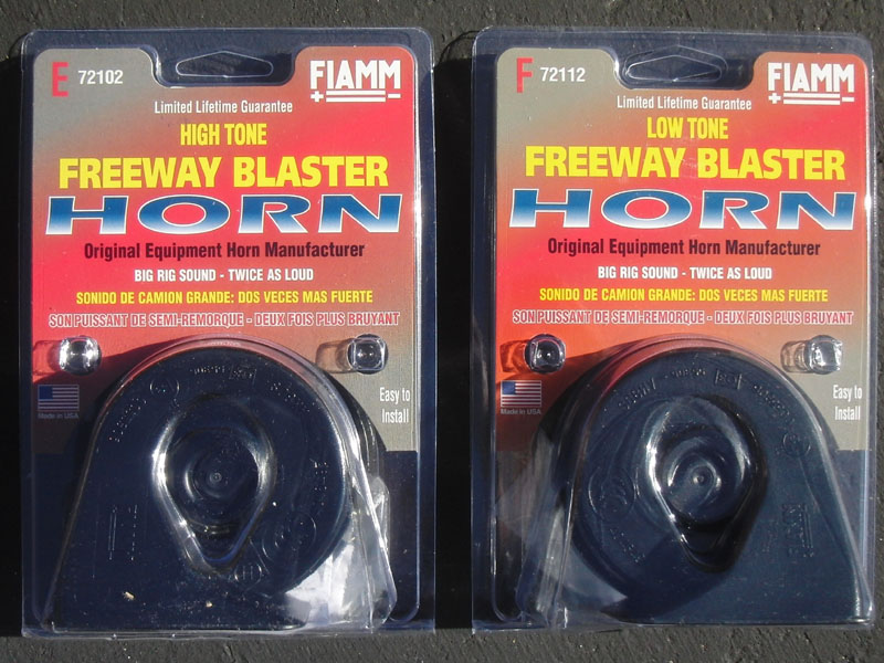

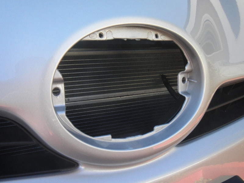

    Just did this mod this morning with the FIAMM's following EVPSs writeup and I must say it was very simple! Definitely a great idea to remove the Toyota emblem as it's very convenient to slip your hand through the hole to access the horns.
    I've never changed out the stock horns on any vehicle and was shocked to see the size difference between the stock Prius horns and the Freeway Blasters! No more MEEP MEEP!

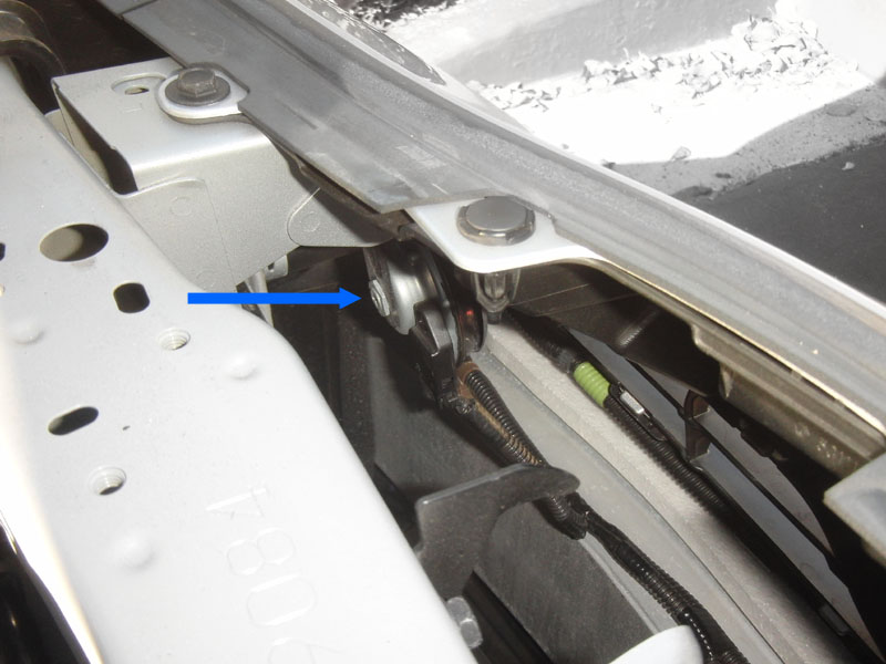

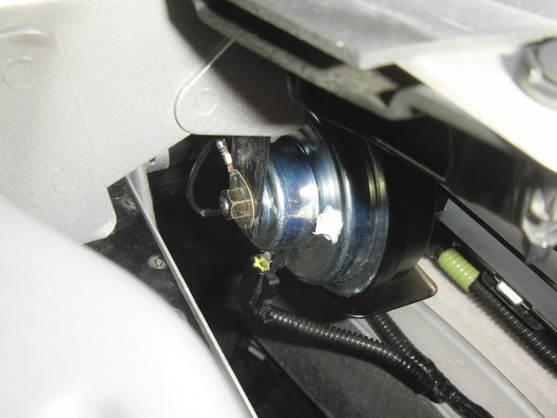

    I've done it with my 5 w/ATP. The DRCC doesn't interfere, but it does help to have small hands. I was able to do the swap out without removing much hardware to gain access.

    FIAMM's came this morning, out of box and installed. Thanks EVPV for the great write up. Took all of about 30 mins from start to button up. Full size car horn sounds great!

    I can't find the FIAMM freeway blasters for less then $16 each on Amazon, where are you guys getting the pair for $20?

    get the FIAMM El Grande instead. Pretty much the same thing but cheaper.

    I listened to them on YouTube and they sounded much weaker. Description also says 110dB instead of 130dB
