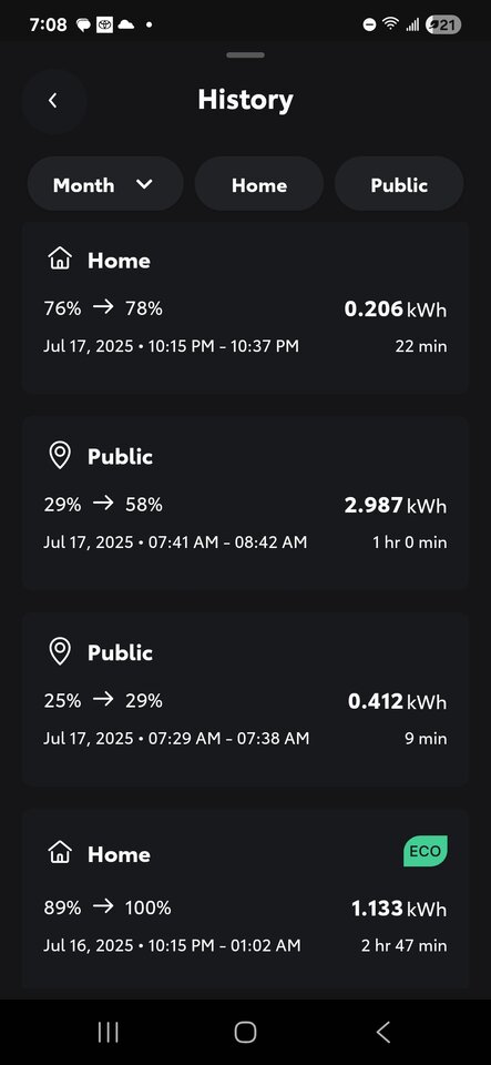

    If the following pics help (see below)
    They are my charging history from my Toyota app.
    You can see from the public charger which is a level 2, it was so mich faster and is the recommended. I believe the manual says this. I am deciding now if to upgrade my electric panel. The rest is from home. You can see at the normal 110 it takes like almost 7hours to go 64% to 100% or more importantly, 3.7kwh. Below, it takes almost 4hrs for 1.7kwh. On a level 2, was like 1 hour for almost 3kwh. But bear in mind, most public chargers will not recharge 100%. Many go 80%, some 85 to 90%, and even fewer to 100%.
    Anyways, back to charging at home. Are there other devices like air conditioners on that same circuit? It takes considerably longer to recharge my car when I also run my AC and gaming computer on the same circuit. My breaker panel tripped when a second AC was turned on lol. Which reminded me of that whole electricity and stuff.
    odb2 and dr prius app Can go some way. But likewise, check your household circuit too!!! The Toyota App is nice in many ways, but a turtle moves faster than the way the info refreshes.
