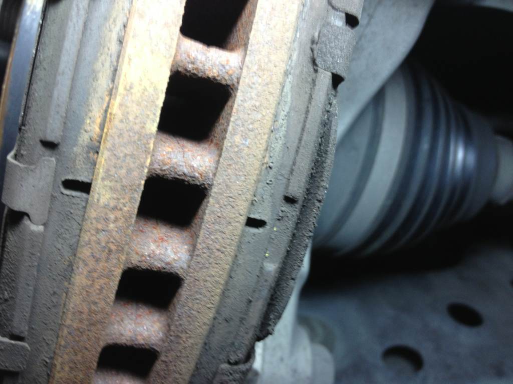

    I would take Mendel's advice if you want to inspect the brake pads yourself. If they truly measure 4mm, you don't have much pad left. The brake pads should be replaced by 3mm, not the wafer thin 1.5-2mm that some people suggest. For comparison, both the US nickel and CA 50 cent piece are almost 2mm thick (1.95mm).

    CA
    4.5mm left at 77k miles.
    I did discover that the front slide pins were almost completely frozen in the bracket. I had to pull very hard for them to come out. Once removed, I lubed them with 3M silicone paste.

    From the Gen III repair manual:
    Front Discs
    New - 10mm
    Replace at 1mm
    Rear Discs
    New - 9.5mm
    Replace at 1mm
  12. Mendel Leisk
    61,558
    42,355
    Yes but: if I pull off a caliper and see brake pads with 2~3 mm remaining, I'm gonna change them.
