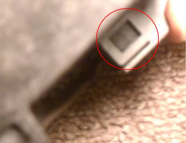

    2. Unsnap two clips above, and one clip on the bottom of the faceplate containing the grooves the gear shift stem travels in. The clip on the bottom is actually on the left side of a square protrusion.

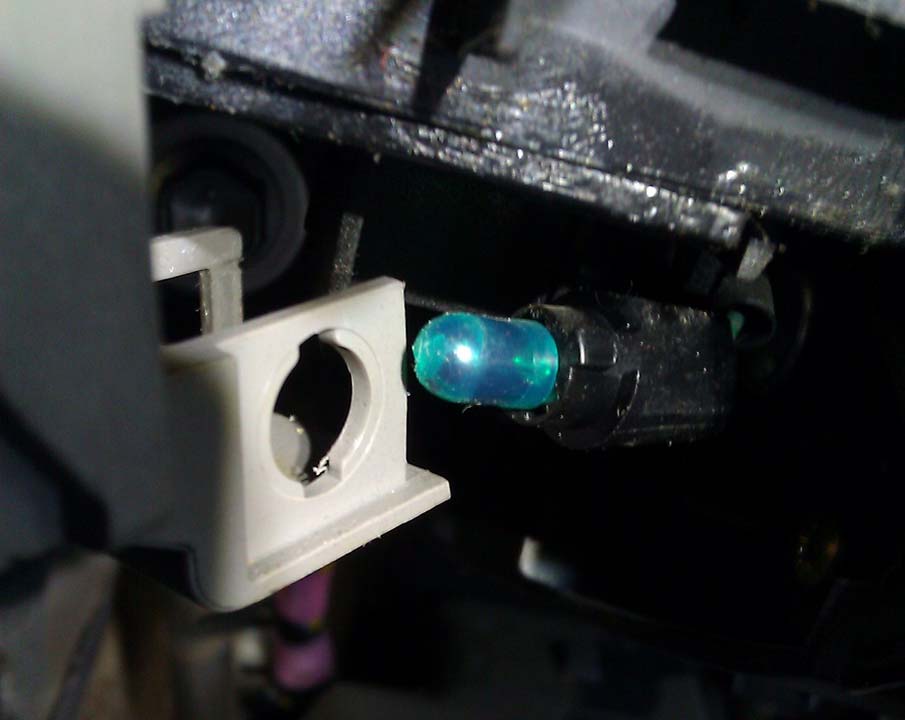

    3. I could not remove the faceplate without removing a small green light with a black base stuck into the right side of the protrusion. To be removed, the light must be rotated 90 degrees using a small needle nose pliers or nimble fingers. I rotated clockwise but I think either way would work.

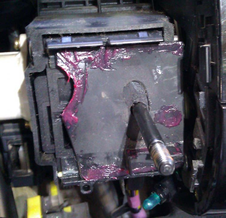

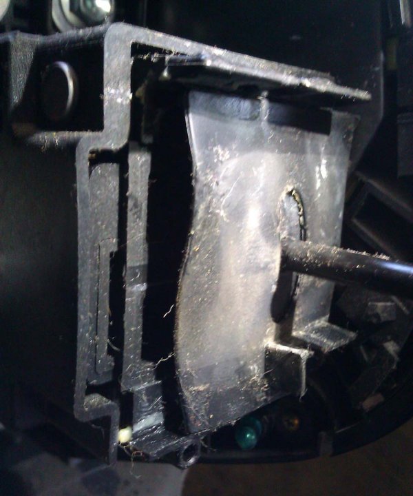

    4. Unlike in the video, where the plastic had a bowed C shape, my plastic has an S shape.

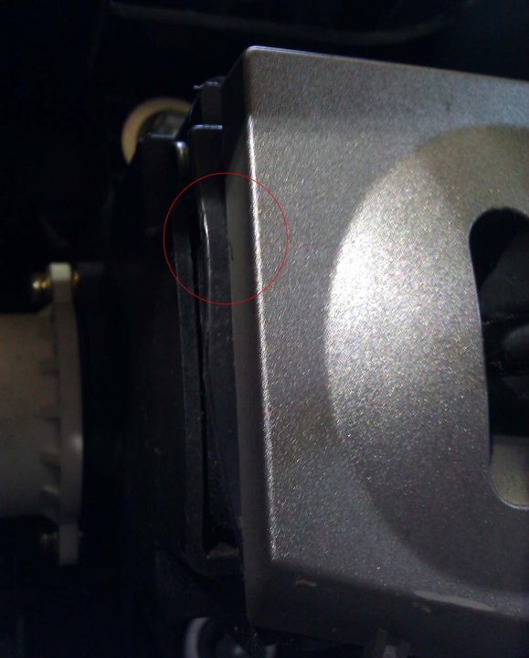

    5. The top curve of the S hits the edge of the faceplate whenever I moved the shifter to the left. The picture shows where the plastic rubs (circled in red).

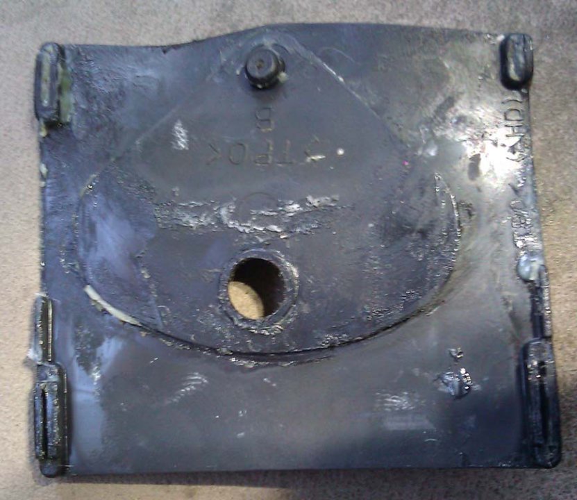

    6. The back of the plastic has a bunch of grease and a roughly triangular piece of plastic that rotates on a pivot at the top of the picture.
    7. It would be nice to just cut off the whole left side of the plastic so it doesn't need to slip out from under the faceplate at all, but that pivot on the back limits how much can be cut off. So I cut a divot into the area that was bowing upward the most, then added MP2 (multi-purpose 2) grease to the front where I could see the plastic had been rubbing.

    I've done teardowns of both the Gen III and Gen II shifters.
    Gen III shifter teardown and examination... | PriusChat
    The apparent offending piece is the PET plastic dust cover that resides under the shift gate. It warps and deforms in heat.
    The shifter will work just fine, if you just remove the offending dust cover. Just don't drop anything into the shifter that will jam it.
