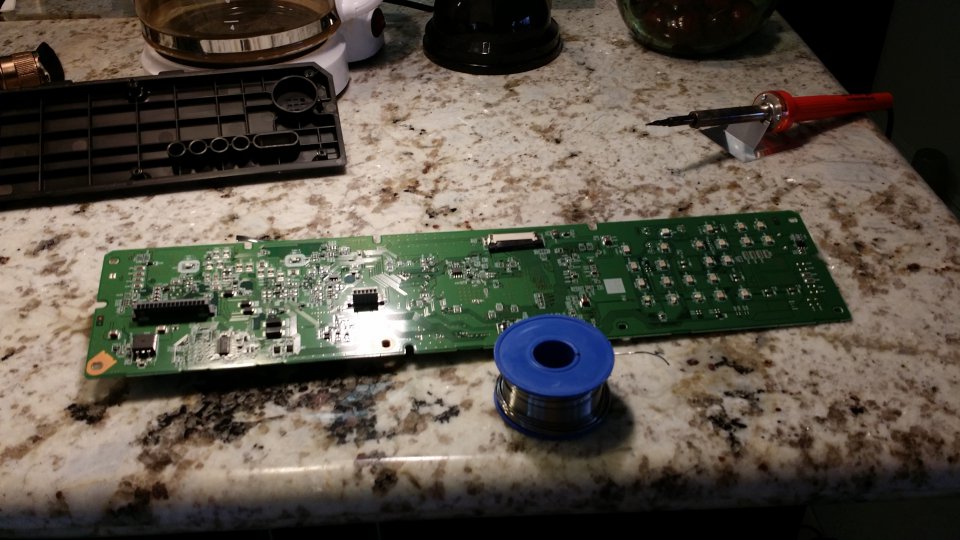

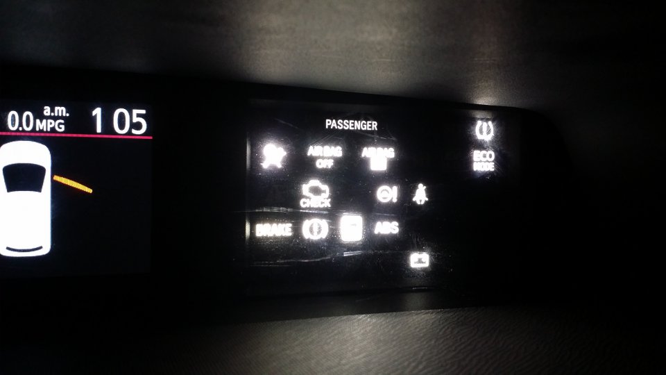

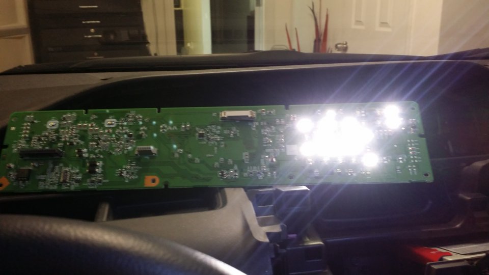

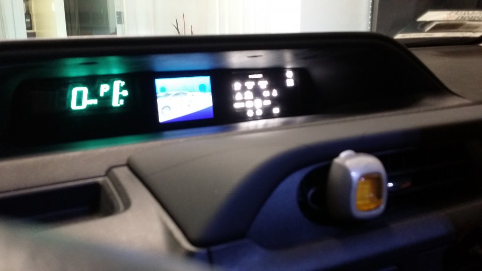

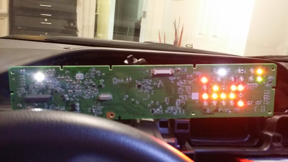

    I wasnt really annoy with the light, but the color I was. it felt like ever time I start the car there was a problem with it like the check engine light so I was bored and change all the led to white. I was bored but took me 2 hour !! what u guy think ??

    I like it. Did you leave the warning lights amber?
