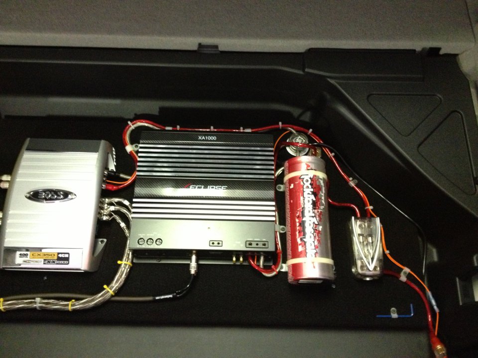

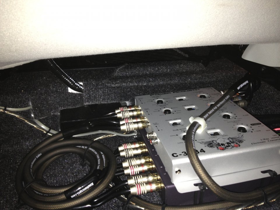

    I put the LOC and X-over under the passenger seat. I broke into the speaker harnesses at the kick panel and rear door connectors so I wouldn't have to pull the HU and also run less speaker cable to into the LOC. My original plan was to connect the LOC to the amps and be done, but I ended up with noise on the woofer, a low periodic rumble. I did a little testing around and found it came from the LOC, so I then added a cheap Power Acoustic crossover into the mix and it cleaned up the sub nicely and gave me a better selection of things to tweak all around. I moved the sub RCA from the LOC to the x-over. Both units take 4 channels in and create 5 out with the sub.
    I did nothing to the dash speakers, still stock. I waited until all else was done and realized they were fine for me.
    I attached a drawing of my system and variations to it based on another wiring diagram I found on the Forum. You'll see how the dash speakers may be wired. My drawing is a little out of date and colors specified may not be accurate. I just need to insert the x-over between the LOC and amps and move the sub output from the LOC to the x-over.
