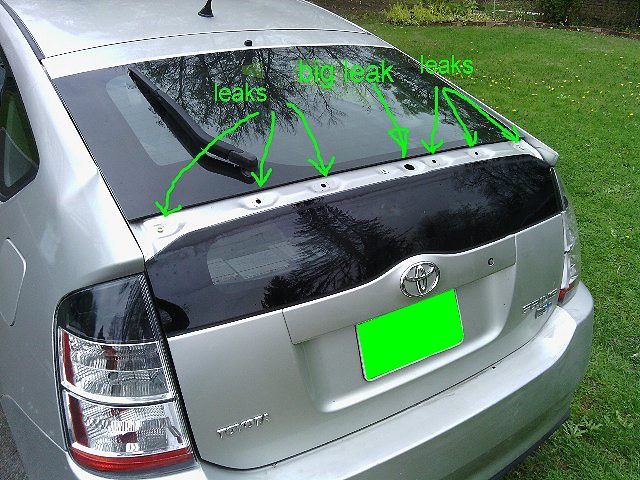

    I just found a HUGE water leak in the back of my 2004
    Prius.
    It came in when I sprayed the hose down the back of the
    rear liftgate window. It seemed to be flooding into that
    little bit of stamped sheet metal running along under
    the window base, and just literally poured out the center
    hole, landing into my spare tire well. It was so bad I
    wondered if there might be a whole part missing up in
    there.

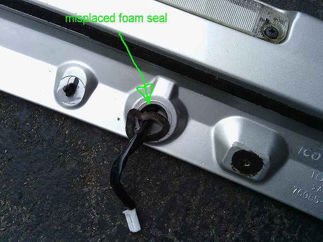

  12. priusrecon
    priusrecon Member
    Feb 10, 2015
    130
    Upstate NY
    Leak Solved.

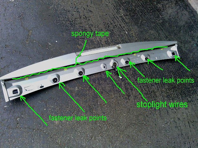

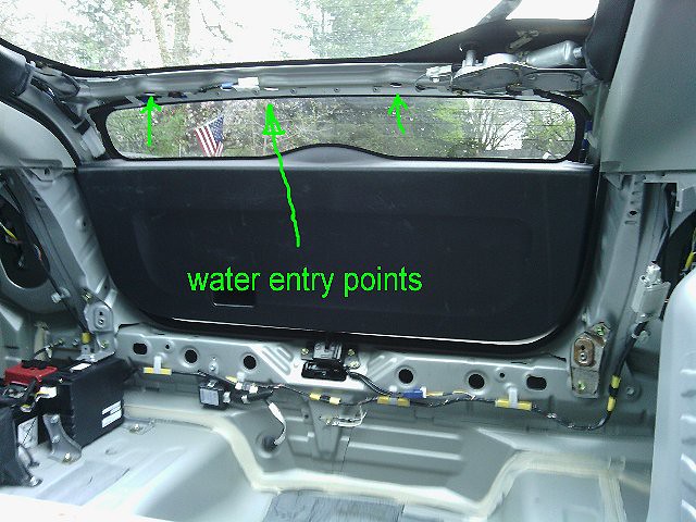

    Pulled rear spoiler plate off, the one joining the two pieces
    of window glass on the lift gate.
    Found there to be no appearent seal from the back of the window
    to underneath the front of the spoiler plate. Don't know if that's
    Toyota's design, or the oversight of the guy who replaced the gate
    glass.
    Also found the foam sealing grommet around the HCSL wires into the
    spoiler to be displaced. See the pictures below....
    Also found there was some sort of spongy tape seal around the BACK
    edge of the spoiler plate that looked like it did more harm than good,
    as it wicked up water and held it there indefinitely, and could only
    serve to promote rust with time.

    If this is Toyota's design, then if that little foam sealing grommet
    around the wires isn't properly applied, then that is the cause of so
    many rear trunk, spare tire well, battery comparment, and rear seat
    footwell leaks.

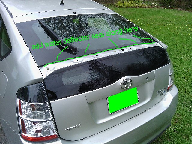

    As it was; as water ran down the back window, it dove under the spoiler
    plate unimpeded by any rain guard, and was trapped under there by the
    rear spongy seal. As it pooled up, it simply ran through the openning
    left by the displaced grommet, into the stamped doubler running
    underneath the rear of the liftgate, and poured out the hole under
    the wire opening into the rear trunk space.
    Also found 7 other potential leakage points under the spoiler plate,
    that if the factory installed seals aren't right, would lead to lots of
    water entry - 4 bolt holes, and 3 plastic snap fasteners with insertion
    points through the sheet metal of the liftgate.

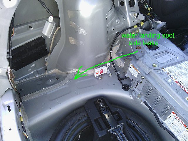

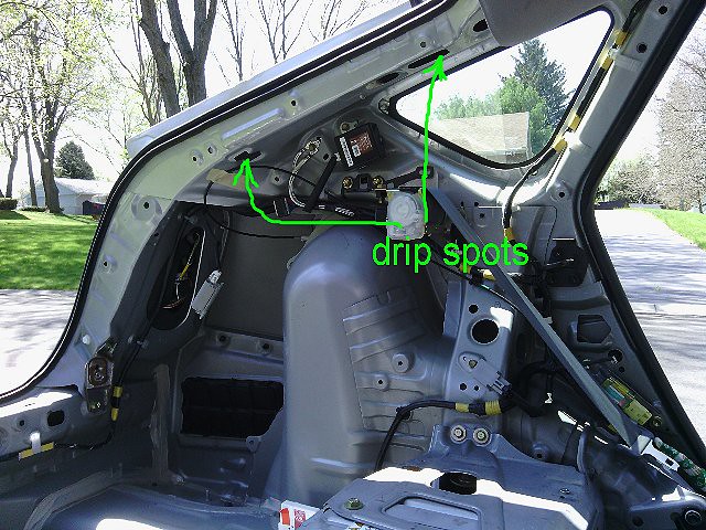

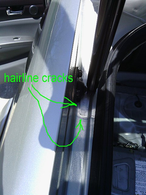

    Also found two leakage points near where the liftgate pistons bolt to
    the car body. Interestingly, the bolt holes weren't the problem, it was
    the tiny microscopic hairline cracks around where it seems sealant was
    applied to cover the weld patch under the bolt on points. Water would
    seep in throught these almost invisible cracks, and run down the interior
    doublers under the side rims of back hatch, where it would drip out of
    two holes, run down the inside of the interior trim, and land on the
    trunk floor.
    After reading so many other's complaints about, and theories
    about leaks in their Prius's, this water source makes sense for all
    of them. As this water leaks in, it accumulates in the spare tire well,
    battery cavity, and upper floor of the trunk well, where it then runs
    forward each time breaks are applied, ending up in the back seat
    footwell spaces.

    Examine the round foam grommet sealing the center stoplight wire bundle for
    proper placement. I got a replacement round rubber grommet from the hardware
    store and pressed it into the hole as a replacement. Had to dremel tool out
    a small tab in the plastic to allow it to fit inside the hole.

    Install a front edge seal for the spoiler plate. I did so by buying some vinyl
    bulb seal tape from the hardware store, cutting it to the length of the leading
    edge of the spoiler. Made a slight notch for the grommet around the wire entrance
    hole. I simply laid it along the base of the rear edge of the window glass, and
    after tucking it under the leading edge of the spoiler, socked the spoiler into
    place with the plastic fasteners and the 4 bolts. Didn't need any glue or sealing
    paste, it's sealed by the clamping force of the leading edge of the spoiler plate
    against the sheet metal of the liftgate itself.

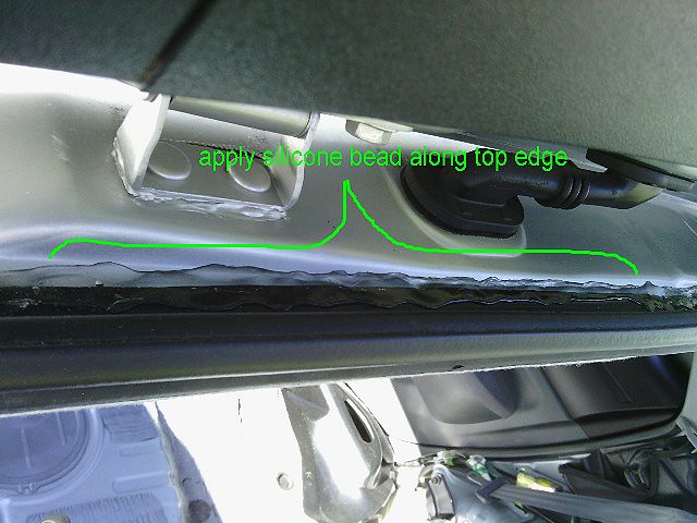

    Used a tube of clear sealant to bead around the entire leading edge of the rubber
    seal on the rim of the liftgate. Also covered those microcracks mentioned earlier
    with electrical tape and sealed them with sealant.
    After this, I flushed it thoroughly with the hose for 5 minutes and not a drop of
    leakage anymore. Whole fix cost $8 in materials and 20 minutes of craftsmanship.
