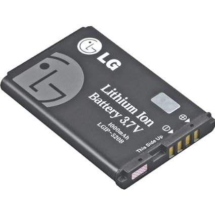

  3. bisco
    114,095
    51,978
    lion.
    Prodigyplace likes this.

  10. fotomoto
    fotomoto Senior Member
    Apr 22, 2009
    5,638
    3,814
    So. Texas
    lion
    LiOn
  11. bisco
    114,095
    51,978
    exaxtsley.(y)
