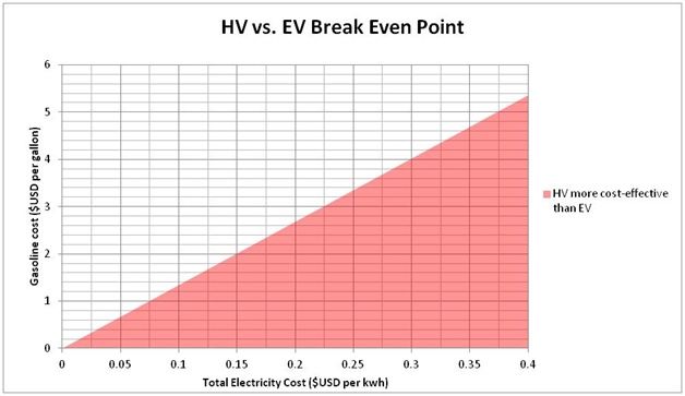

    As I was sighing over my high local electricity costs, I figured that others might be interested to know whether it's more cost-effective to run your Prime exclusively in EV mode, or whether you'd be saving money running in hybrid mode. External and long-term costs to society of higher emissions not included. ;)
    This presumes Toyota's specs - 25 mile range on a full charge, 6.2 kwh per full charge (8.8 kwh battery not using the bottom or top 15% of its capacity by design), 54 MPG overall from your gas. The break-even point where running in HV costs as much as running in EV is ($/gallon) = 13.392 x ($/kwh) When figuring your electrical cost, be sure you include all charges, supply and delivery! If you spot an error in my back-of-the-envelope calculations, let me know.

    Nice chart! It gets complicated when you can plug in sometimes for free, like at work or some stores. But for most of us, that chart makes it very easy to get a handle on the relative costs. I would estimate that I only pay for about 2/3 of the kWh I use in my PiP.

  8. Ducky
    Ducky Member
    Jun 17, 2017
    South Shore, MA
    Handy, thanks! Hmm, not quite a match, but really close. For instance, I found break-even 10 cents/kwh to be at 1.3392, vs. 1.37 in the chart. I wonder what the distinction is between the calculations? MPG at 54 for both, so presumably slightly different amounts of battery being used, or slightly different distances traveled on a full charge.

    I used the EPA number of 133MPGe. Maybe that's the difference.

    Aha! Good call, that's probably it. I set mine up like this:
    ($ per kwh * 6.2) / 25 = $ per gallon / 54

    The EPA approach would be:
    ($ per kwh * 6.33) / 25 = $ per gallon / 54
