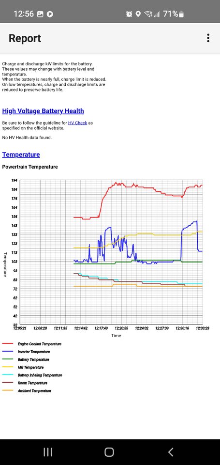

    I am tracking my stats with hybrid assistant and it is not quite warm enough to trip the error but I did find a strange temp reading on my inverter. When it turns on my inverter temp spikes up instantly 30f and when it turns of it instantly looses those 30f. Attached is a pic of temps at the end the car is not moving and the battery is being recharged when the inverter temp spikes.
