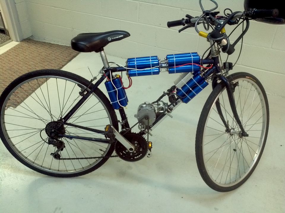

    not to hyjack my own post but am am rather into ev tech, I have an ebike smallscale experiment and I plan on a windmill to charge it given the dirty electricity mentioned, heck doing away with dte is up there on my list of things to do, thou small scale involves bateries expensive inverters, not to get into it too deep there is no payout, theres got to be a different way, too much for too little type deal.
