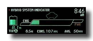

    Just like last time, the ICE had run the previous evening. At the time of this incident there hadn't been but two miles on the motor since the ICE last ran. No fan, no A/C, no defrost, not even the radio, and no acceleration into the power portion on the HSI display. The car simply refused to operate in EV mode until it was "rebooted." Next time I will video the various displays while I am driving. You let me know what's most convincing for you. I'm thinking the HSI and Energy Monitor screens should be good to show the ICE turning on and off under light acceleration and deceleration while speed remains under 40 mph and no accessories are on. It should be clear from those two displays that the car is supposed to be in EV mode by the lack of a band in the middle of the power bar, but I'll make sure to include the EV mode above the speedo too. Is there more?

    And here's what the modes look like...
    HV has the 2 symbols:
    EV has only the 1 symbol:
    Above, even though the EV isn't shown, you're still in EV mode.
    Below is what EV looks like when the engine isn't running. Just the outline means it is.
    Adam Leibovitch and lensovet like this.
