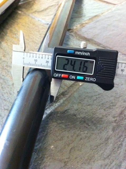

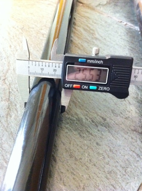

    Here's two pics of the sway bars; first my original(24.2mm) and the RAV4(25.5mm).
    I also weighed the bars with the bushings and they were 6.94 lbs vs 9.04 lbs.
    The RAV4 bar fits perfectly. Since I had the lower plastic panels removed, I changed my engine oil/filter, rotated the tires and adjusted the air pressure. I've only driven around the block so far; all is good and it feels firmer :)

    Prius sway bar hollow?
    I measured the linear length of the original bar approx. 135cm.
    I also re-weighed the sway bar without the bushings: 6.46lb
    The diameter of the bar, as mentioned earlier, 24.16mm = 2.416cm
    If we calculate the volume of a cylinder = length x Pi x radius**2
    which is 135cm x 3.1459 x (2.416/2)**2 = 619.7 cm3
    The density of iron is 7.86g/cm3
    mass = volume * density = 619.7 cm3 x 7.86 g/cm3 = 4871 grams = 10.7 lbs
    Since the bar is only 6.46 lbs, it must be hollow.
    Please note, my measurement could be off a bit, but not by much.
    There can be a slight difference since the sway bar is most likely an alloy
    not 100% iron(Fe), the bar was painted, so the diameter includes the paint...
    But even so, I don't think it will be off by 4 lbs...so it must be hollow.
    If I do a similar calculations with the RAV4 bar...using some values above, since the
    bar is installed on my car...
    linear length: 135cm
    weight of bushings = 6.94 - 6.46 lbs = 0.48 lbs
    weight of RAV4 bar = 9.04 - 0.48 = 8.56 lbs
    diameter of bar = 25.53 mm = 2.553 cm
    volume = 135cm x 3.1459 x (2.553/2)**2 = 692 cm3
    mass = 692 cm3 x 7.86 g/cm3 = 5439 grams = 11.9 lbs
    Since the bar is 8.56 lbs it's appears to be hollow...
    At least the ratios of the weight from Hollow/Solid seems to be greater for the RAV4 bar...
    6.46/10.7 vs 8.56/11.9 (RAV4)
    0.60 vs 0.72 (RAV4)
    I drove my first commute day with the RAV4 bar, it seems to corner flatter and feels sturdy.
