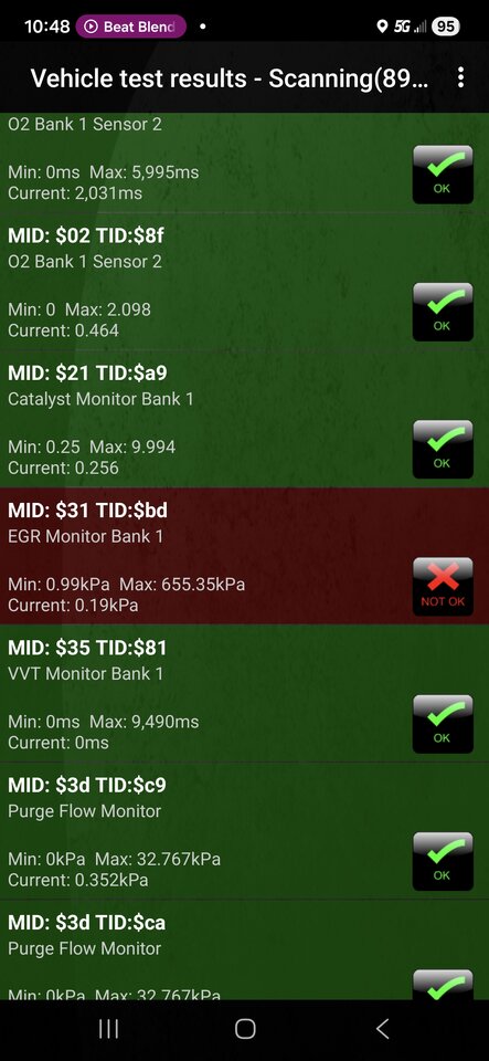

    Still have a p0401 code which is EGR flow insufficient. Wondering if its the valve, maybe the diaphragm and unfortunately sub-assembly parts aren't sold individually. Or it could be the sensor? The $200 something sensor . Probably both are the issue given my luck.
    What would you replace first the valve assembly or the sensor? Both are similar $$ so they easy choice of going with the cheaper first doesn't really pertain.

    Loosen 2 screws and you can take the stator off that EGR valve, unscrew the rotor and look inside to see if the ski-jump inside has a rut through it. That can give you a P0401.

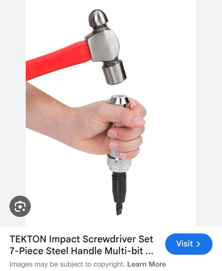

    Maybe dissimilar metals, for some reason, those screws can be a bear.
    For me setting the valve on a stump section, with blocking under to protect the studs, then tapping the screws with an impact driver and hefty hammer did the trick. Something like this:
    I replaced them with M4x16 socket head cap screws, hopefully make it easier if there’s a next time.

    I have the same kind of hand impact tool, and a hammer about like what's shown in that picture (which I don't know that I'd call 'hefty').
    In my experience, what those screws need is a couple casual bops on the impact tool to surprise them loose, and after that, you can spin them the whole rest of the way out with fingers. Certainly not the kind of stubborn that would make me bother replacing them with anything else.
    But it is good to mention the impact tool, Those initial casual bops make a real difference, and people who try to just muscle those screws loose with a plain screwdriver do often post here about having stripped the heads.
