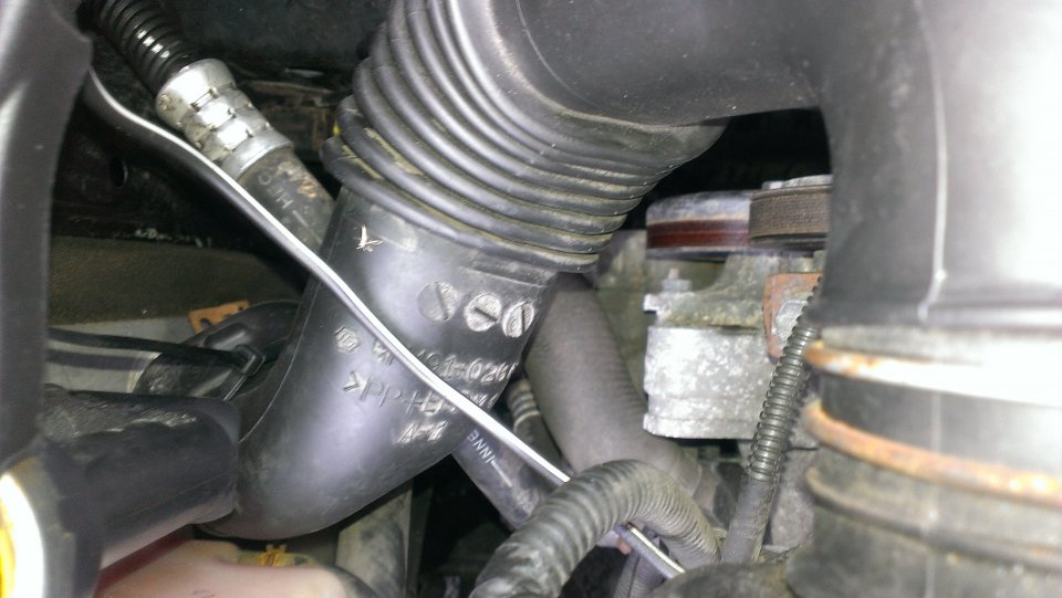

    pictures please
  5. numba41
    numba41 Junior Member
    May 3, 2014
    42
    Ashburn, VA
    See uploaded pic.

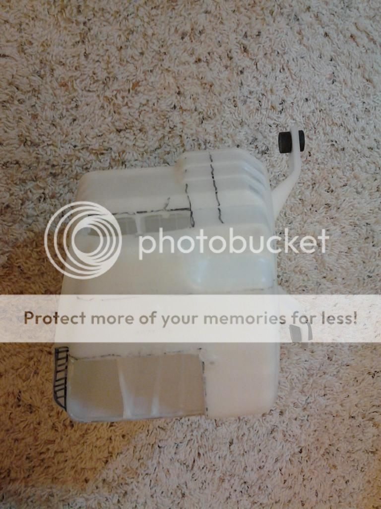

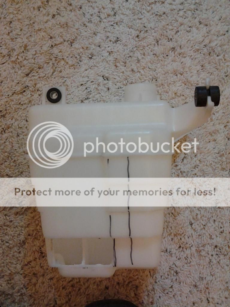

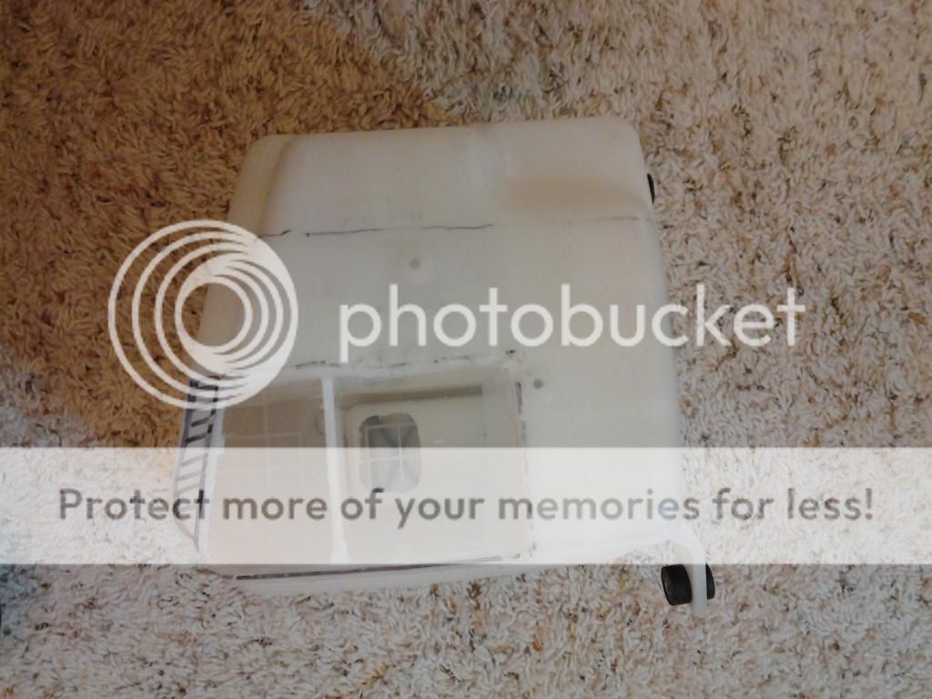

    I really wanted something that would draw cold air in from behind the passenger front tire. I tried everything to get a 3 inch PVC tube to snake down behind the pass. headlight assembly and down directly in front of the pass. tire. I got it to kind of work, but I had a hard time mounting the tubes to the body of the car, so it kept flopping around in the engine bay and making a lot of noise. What I decided to do is use the stock pieces, but modify the resonator so that it would become the main source of air flow. I cut holes in the bottom and side of the resonator (because there are separate chambers inside the resonator).
    From my other post I heard many people say that "oh it'll draw water up into the engine and you'll get hydro-locked" I've had this set up on my car for almost 2 years now without any issues. Remember that any water droplets that gets sucked up into the air intake system, will have to travel up through the tube, then enter the airbox where the air flows up into the airbox, then across the top of the airbox, through the carbon filter, then down into the air filter and then finally makes it's way into the throttle body.
    I've tested my setup by placing a FRAM paper filter in the airbox and then driving 80 miles through a rain storm. If any water was to be sucked up in the system the paper filter would be wet after driving through the rain. When I checked the filter the paper was dry and showed no signs of moisture or water contamination.
    For the resonator to be completely blocked by water, you'd have to be in almost 2 feet of standing water. If your Prius is in 2 feet of water, you have bigger issues to worry about than water being drawn into the air intake system. You need to find a life raft! -- Please note that the Prius is not designed to be a submersible vehicle; it is not a boat.

    I tried it with the resonator removed, but wanted to get the air intake point as low to the road surface as possible. The resonator adds another 8 or so inches, which is why I cut the openings at the bottom.

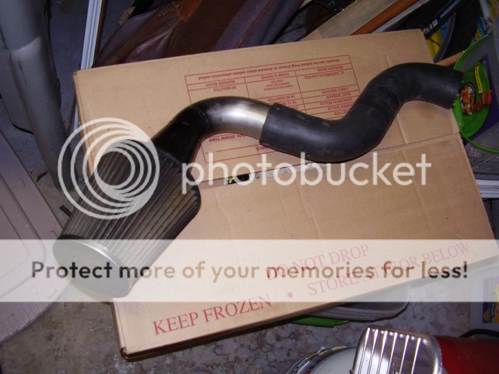

    this is what I did
    it attaches to the air filter box. the cone filter just barely fits under the headlight.
    Woodstock74 and Daves09prius like this.
