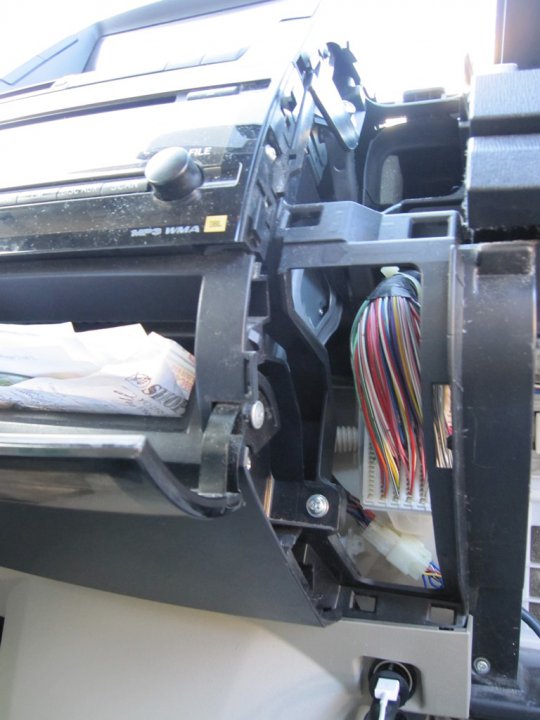

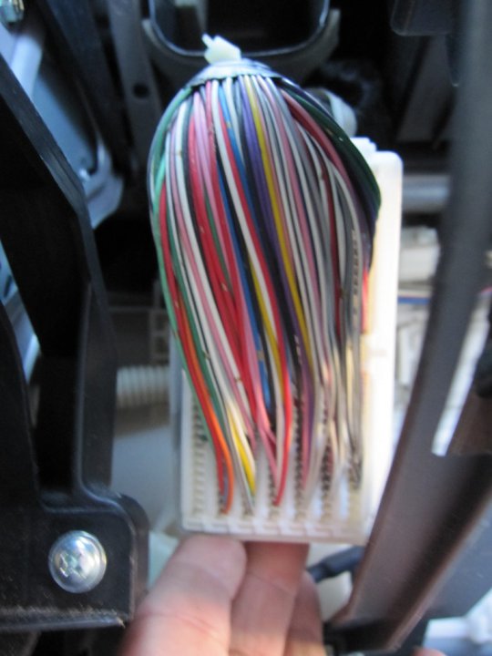

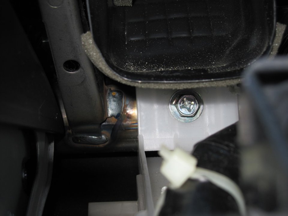

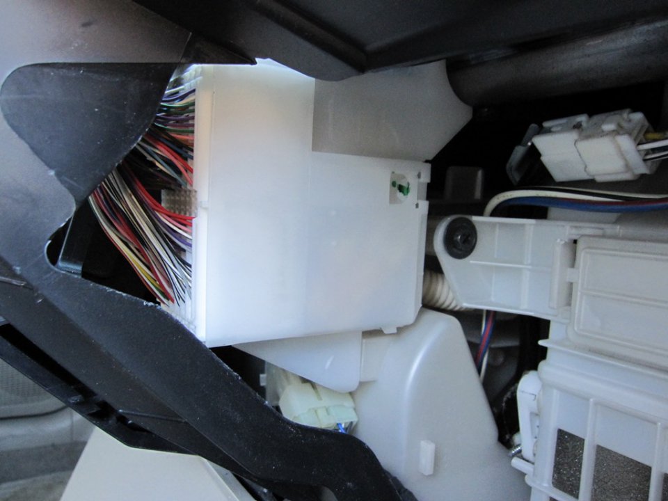

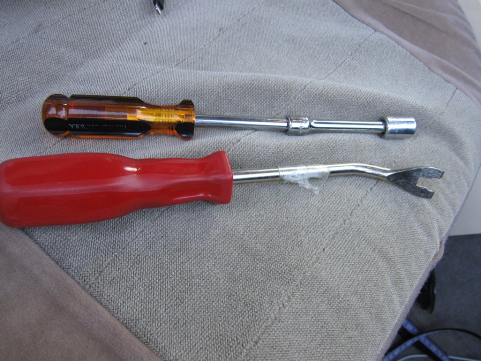

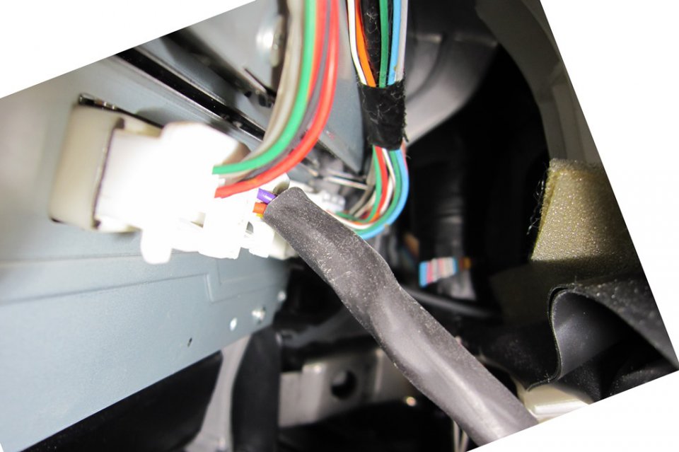

    I went ahead and removed the register trim and took some more pictures. Open both top and bottom of glove box to get rim tool under edge of trim to get started. I didn't remove the cable, but one pic, cable with tape, wires running down, should give you a better idea where it's located. Need a trim tool to remove register, a 10mm socket and a couple extensions to remove bolt holding white wire harness behind the trim to move it just enough to get in. I forgot that step. I installed my iPod adapter about 2 years ago. The connection is 2nd from left as you're looking at back of radio. Pics attached. I think this wire harness probably has every wire in the dash running through it. BE GENTLE!!
