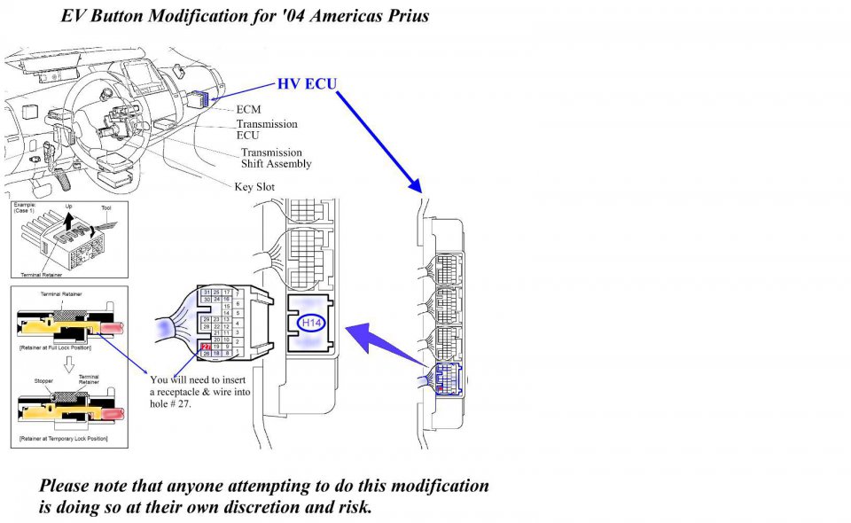

    This is an interesting thread. I purchased the EV switch from Sigma and have a question about wiring it in my RX400h. Is the location of the HV ECM the same as in the Prius? Pin #27? If so, I'm assuming that the install would be similar to the Calcar link.
