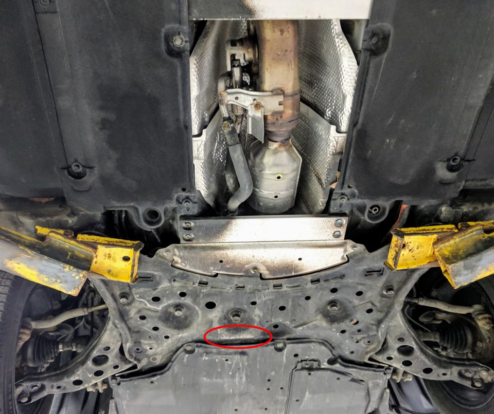

    I see that spot in the manual, but it's impossible to see when the car is on the floor. But as you can see in the picture below, the spot they call for is only a couple inches from that bolt. Now that I know it's there, I might give it a shot, but I didn't even see it after I got under the car and looked for it. It's so close to the shield, I'm not sure I can count on hitting it with the jack cradle and not also catching the shield since it's impossible to get a good look at it. In fact, my jack cradle might actually be bigger than that area that's circled in the manual.

    I thought about spray painting that spot with highlight color for an easy identification, but I haven't. Yeah, trying to hit that front jacking point is so difficult and cumbersome, I have resorted to jacking mine up from the sides for now. I think it is just as quick as fiddling with the center jack point.

    I didn't look for that beam when I had the cover off. Check out the left side of the picture in post #521 from the manual. There is nothing but plastic from the front bumper back to the lift point behind the front wheels. It's one big sheet that you remove to get to the transaxle and other stuff. And there's another sheet that continues on to the front of the car. The one you remove is actually shingled under the front one. No lifting point at all.

    If there was a good lifting point father forward, I'd think they'd have put a hole there. I sure didn't see anything like a lift point when I had the plastic off. It's just safer to use the spot in the manual. Not that big a deal to drive the front wheels onto a couple boards and roll the jack back there. It was just a pain to work out the system the first time. Once you know, you're good to go.
