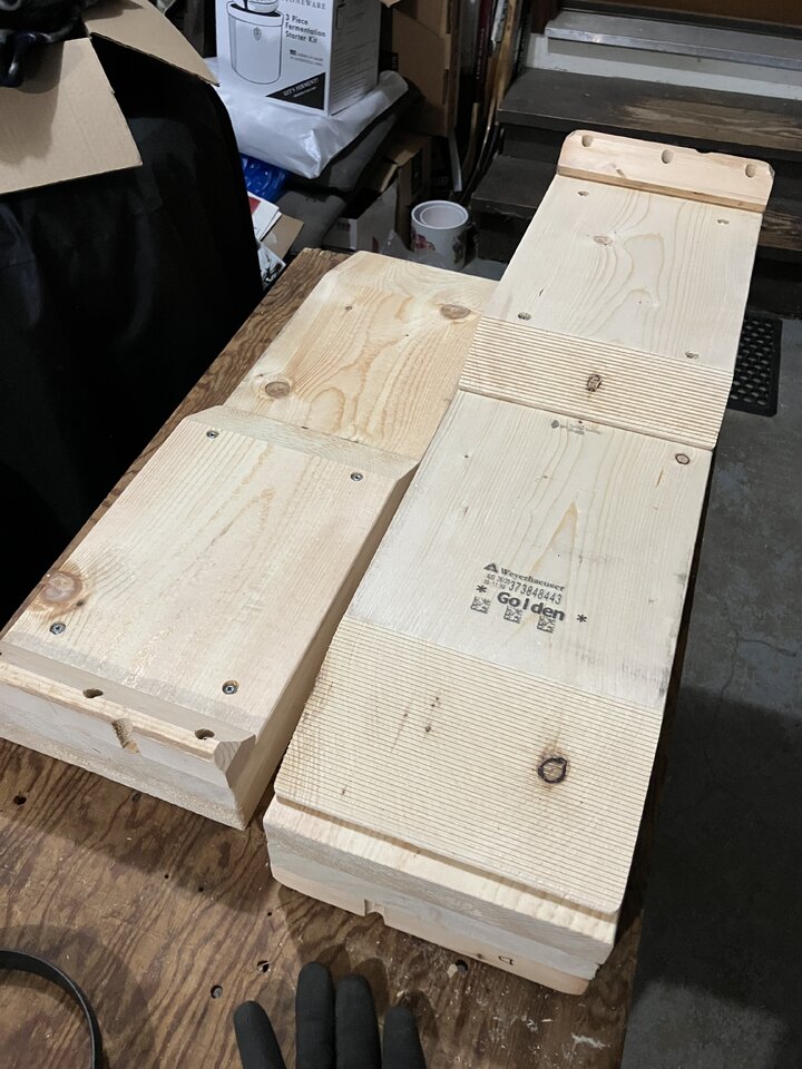

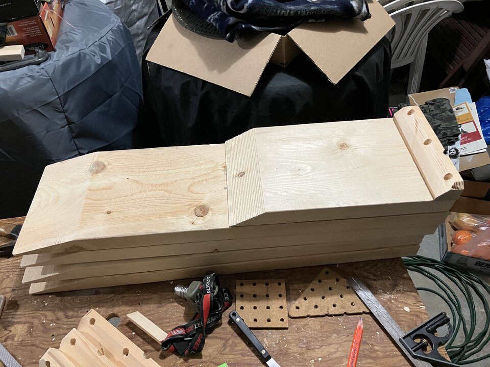

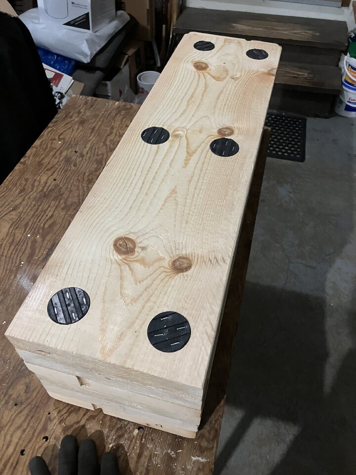

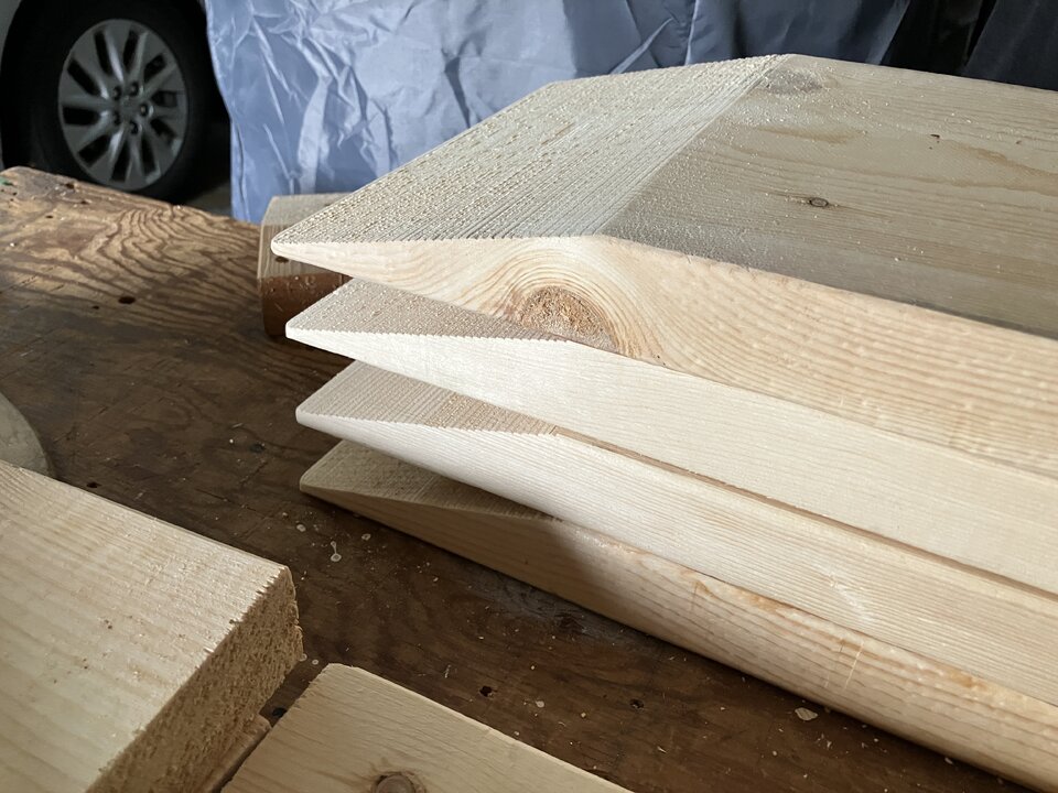

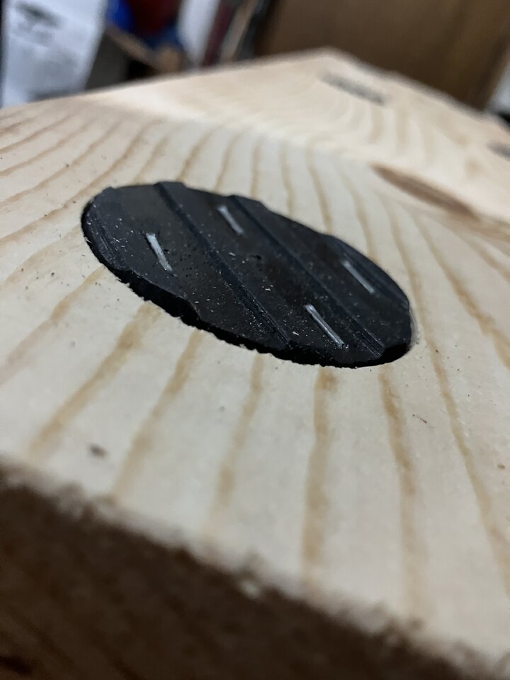

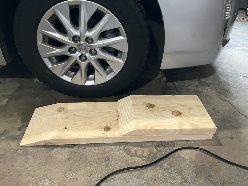

    Nice design, but for just 3" lift, you don't even need a stop on it, because driving off the end of it has no bad consequences. It doesn't hit the bumper on the way in, it doesn't hit the rocker panel if you drive past its end, or spit it out with wheel spin. I can't count the times I've had wheelspin kick something out, in a way which might wreck your stop on this one. It's why I also prefer having the bottom layer stick out more, to reduce the chance of it kicking out or flipping up when you drive on. To make 2 from an 8 footer, I'd just cut them 30 and 18. To make 3 in order to have a spare, 20 and 12. To make 4, 15 and 9. Whether to center the top piece, make them unequal, or make one end flush, is a matter of taste and whether you want different options from opposite ends or not, especially regarding getting it to work for rear, undriven wheels without just sliding and not going up on it. I prefer unequal, to have options.
    I don't like the sheet metal reinforcement idea. Tires are expensive, I don't want to cut them if I'm not centered and wheel spin kicks it out. A stop is very important when the lift is high enough that going off the end will crunch your rocker panel. Unimportant when it won't. And the worst case, is if it wouldn't crunch it if the stop where there, and would crunch it if the stop is there and you get past it. It would appear the stop would end up OK in the wheel well, but don't underestimate how quickly the car can spit it out under the rocker panel, faster than the car drops from gravity.

    I’ve been up to something:
    IMG_2421.jpeg IMG_2407.jpeg IMG_2410.jpeg IMG_2414.jpeg IMG_2447.jpeg IMG_2445.jpeg IMG_2446.jpeg
