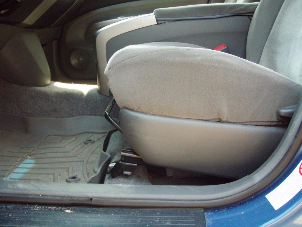

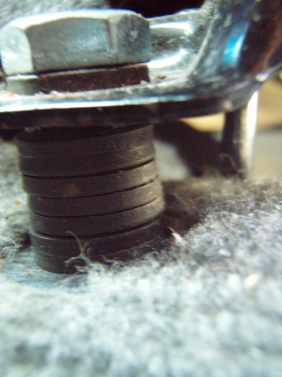

    Definitely gonna try this as well - 6'2" - all legs....
    Did my own Front Seat tilt mod. So much more comfortable than before!!
