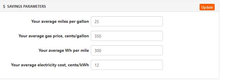

    Juice Plug says I have 18 miles added. Car say's I have 30.6 Miles EV:eek:
    You can adjust that in the settings. :p
    here? or in the phone app? and if here, what do you suggest I put in? 1 settings in Juice Plug.JPG

    Either one will do it. It's just an estimate.
    I'd adjust the other parameters too. Gas isn't $3.50.

    What do I put in for average WH per mile?

    Great question. Can't remember where I found it but I set it to 253, but that was just a search in this forum.

    Ok, I will do the same, My average electricity costs? well since I pay $15.00/mo no matter how much electricity I consume. (because that's what my landlord charges me) I got a hold of the DTE summary (DTE is Detroit Edison) and it looks like my landlord is on a commercial rate so he pays 9 cents per kwh.

    For "Your average Wh per mile 300" I would use either:
    • (18/30.6) * 300 ~= 177 Wh per mile
    • 25kWh / 100 mi ~= 250 Wh per mile
    • 233 Wh per mile, what I'm using
    However, I switched to 'SOC %' and kWh because the rate of electrical consumption per mile is a strong function of the speed and driving style. In the case of our BMW i3-REx, ambient temperature. I'm seeing +100 miles on the estimated electrical range now that we're in mid-70s. So my rule of thumb:
    • Prime - 100% SOC ~= 30 miles so 33% ~= 10 miles
    • BMW - 100% SOC ~= 70-100 miles so 1% ~= 1 mile
