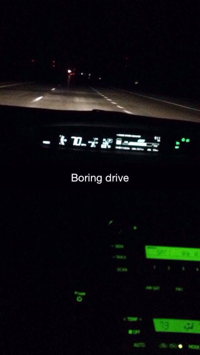

  10. defrankond
    defrankond Member
    Apr 30, 2010
    217
    23
    North Dakota
    image.jpg I like the LED lights honestly. Here is a pic of them at night
