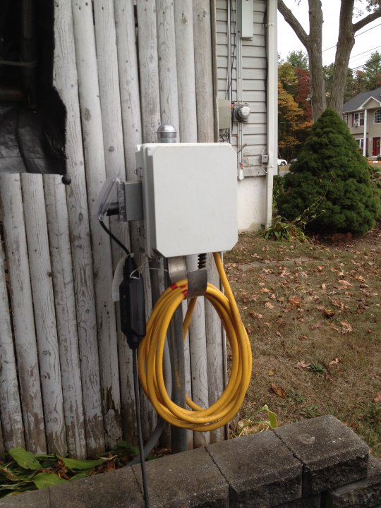

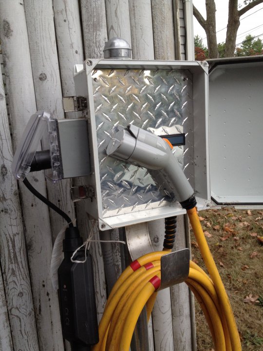

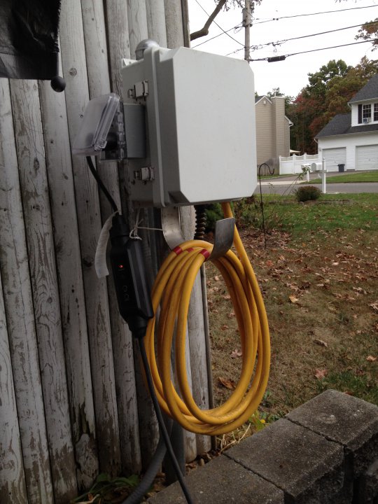

    I build an Open EVSE and it guards my driveway.
    240 VAC 60 Amps and 120 VAC at 20 Amps.
    giora likes this.
