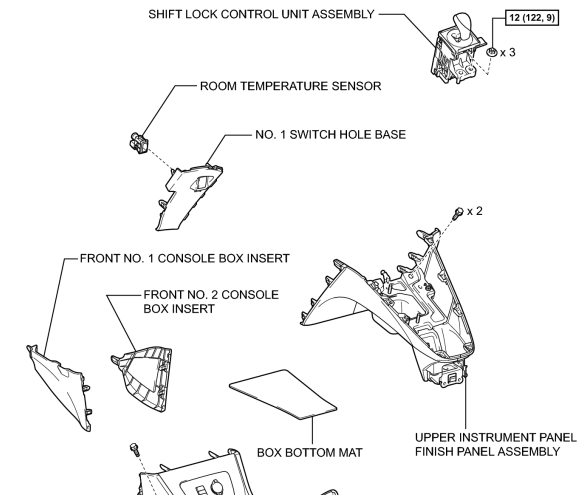

    The cabin temp sensor is located behind the blank switch plate (or switch, depending on model) by your right knee. There are openings just underneath the switch that you can feel with your fingers. This is where the air temp is sensed.

    The "No. 1 Switch Hole Base" is located by your right knee, not below the console. The repair manual is just showing all of the center console pieces that have to be removed in order to access the Switch Hole Base and the temperature sensor. If you put your finger underneath the switch hole base you will feel the slots where the air temp is sensed.

    Thanks for setting me straight on this location. I would have never have guessed with having to remove all that is necessary that the sensor is actually located behind the Switch Hole by your right knee :). I have never noticed the vents below the switch hole.

    Isn't that the truth! The interesting thing is I removed the blank switch cover and you can see the connector harness and you can see the sensor through the vent slots. It is right there at your fingertips.

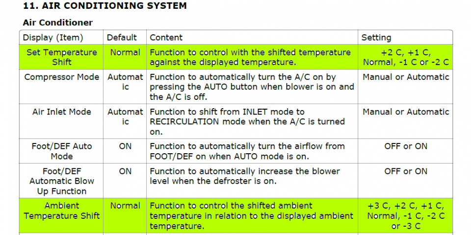

    And here's the kicker - the various temperature sensor settings are dealer-adjustable.
