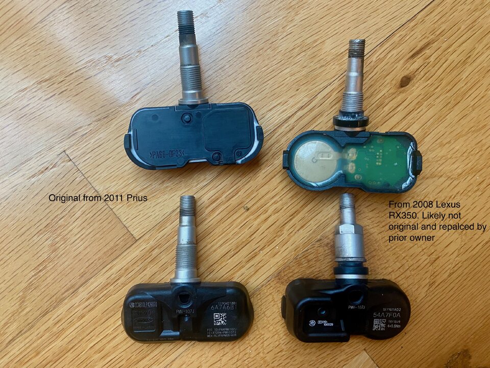

    Just went through this with a 2008 Lexus RX350 but all the methods are identical for Gen3 Prius (and many other cars)
    Avoid cheap no name brands from ebay/amazon. I figure these were all from the supply chain of cheap Chinese domestic cars. Use cheap and lower quality batteries and internal chips (low power design matters for longevity) Thus I guess life span likely isn't great.
    High end TPMS from Japanese, US and German brands provide high quality aftermarkets. However, a single confusing factor creates massive confusion amongst consumers and tire shops benefit handsomely. The single factor is high end TPMS ID programming (inserting an ID into the TPMS sensor) require thousand dollar tools that mainly work with one brand. Tire shops don't carry every expensive ID programming tool so they just resort to sell you a TPMS they carry and can program at a handsome markup.
    Here is how to get around all of this confusion at low cost
    Buy high end TPMS from online seller preconfigured for your car
    tpms.com and a2ztiresupplies.com (used them recently) are such providers. When you order TPMS, provide your car's model and they will preconfigure the TPMS to be compatible with your car. All that is left to do after installing into a car is to read the IDs and program them into the car's ECU. Fortunately this last step can be done by a programmer every tire shop has (Autel MaxiTPMS) Its so cheap even a consumer can own one for < $100 (more on this later) I even asked a2ztiresupplies.com to write the ID on the box so I can program into the car with Techstream (but their handwriting wasn't so good haha)
    High end TPMS maker like BH Sens Huf, Autel etc. make dual band sensors (315Mhz, 433Mhz) and blank IDs. So a seller just need their tool to config the correct band for your car and enter an ID. Again, the challenge is this config tool usually only work with a single high end brand. So buy from online sellers that preconfig these for your car are the way to go.
    Installation when you change tires or just swapping dead TPMS
    Can usually get these installed for free while swapping out for new tires. Shop might even activate them for you for free (Costco did for me when I provided them preconfig sensors) If swapping out a dead sensor without new tires, Discount Tires just did 3 (preconfiged for car + ID) for me @ $8 each without programming it into my car. Used my own Autel MaxiTPMS to program the car with these new IDs. Could have done it with techstream if the ID written on the box was more clear haha.

    • Read my 11 Prius TPMSs and set them into the car. Used techstream to blank out TPMS ID in the car ECU in advance to confirm MaxiTPMS did the programming into the Prius.
    • Put 3x BH Sens TPMS into a 2008 Lexus RX350 with 3x old TPMS (1 dead) for $24+tax install at Discount Tires. Read all 5 TPMS (2 installed last year by tire shop) and programmed into the car.

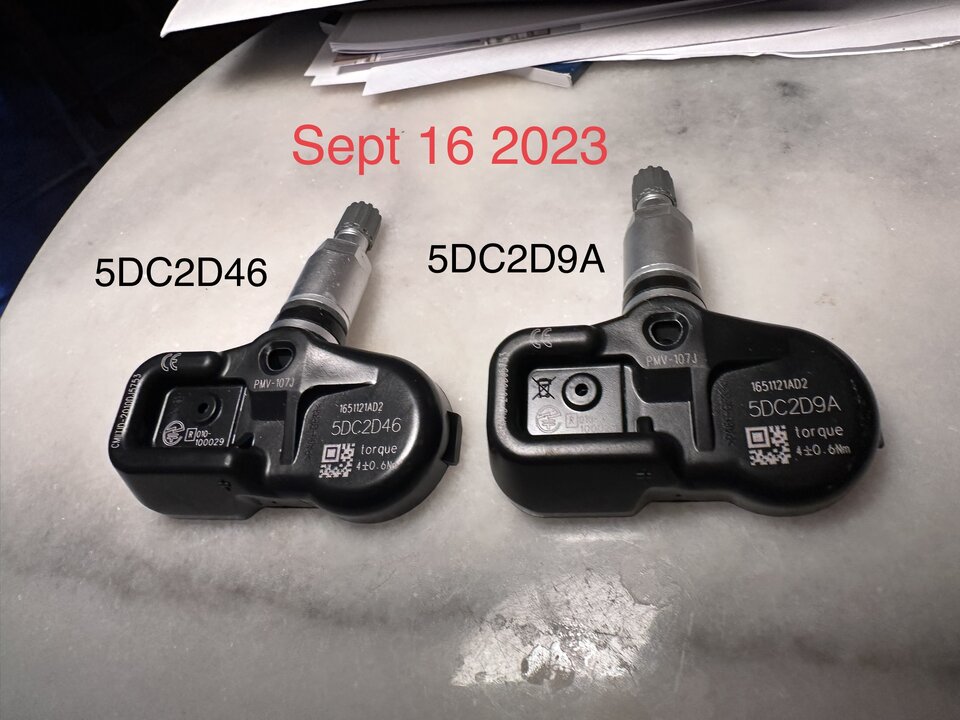

    This is a serious case of over thinking something that is easy.
    First "high end" tpms sensors from Toyota and everybody else including the cheap $40 a set brands already have a unique id set in them and printed on the sensor.
    $40 a set of four from Amazon
    So buying from those guys add no value ESPECIALLY when you still have to set the car's tpms ecu with Techstream or an aftermarket tool like Autel sells.

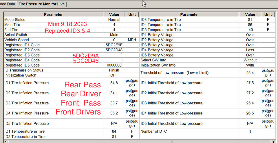

    Adding above sensors into tpms ecu
    The above can be done with Techstream or the $264 Autel MaxiTPMS ecu programmer.
    Xtool and others have lower cost ecu id write tools but Autel is the standard short of Techstream.

    On Autel program Gen 3 Prius ECU
    I can confirm Autel TS508WF scanned all 4 of my Pacific Industries TPMS purchase a couple of years ago ($40/ea Amazon, seller is Denso whatever that means on Amazon. rockauto is also ~$40/ea) and wrote into the 2011 Prius ECU a couple of days ago. Did this to test my just purchased TS508WF. But I recall it took 2 tries on the ODB2 write effort. Maybe user error as it was my first time using the Autel to program ECU.
    To confirm the Autel did the programming. I use techstream to reorder the IDs (what ID1-4 corresponds to) to see if Autel would change the order. And of course I made a typo and TPMS light on dash came on haha. After Autel successfully programmed. Order changed, typo was gone, TPMS light went out :)
    Also used this TS508WF to scan and program into ECU on 2008 Lexus RX350 yesterday. 2x unknown TPMS Les Schwab put in a year ago. 3x new BH Sens UVS 7050 preset with ID by the seller (I triggered the TPMS with TS508WF to confirm before tire installer visit which also clarified the poor ID handwriting on the box that I asked for) I asked for the 3 old TPMS back. Looks like prior owner probably replaced with cheap counterfeits. Here are the pics. Seems like an attempt at copying Pacific Industries poorly. Disregard the transparent silcone and no rear cover. The $40/ea Pacific Industries TPMS form Amazon is same so Pacific Industries changed the assembly since 2011.
