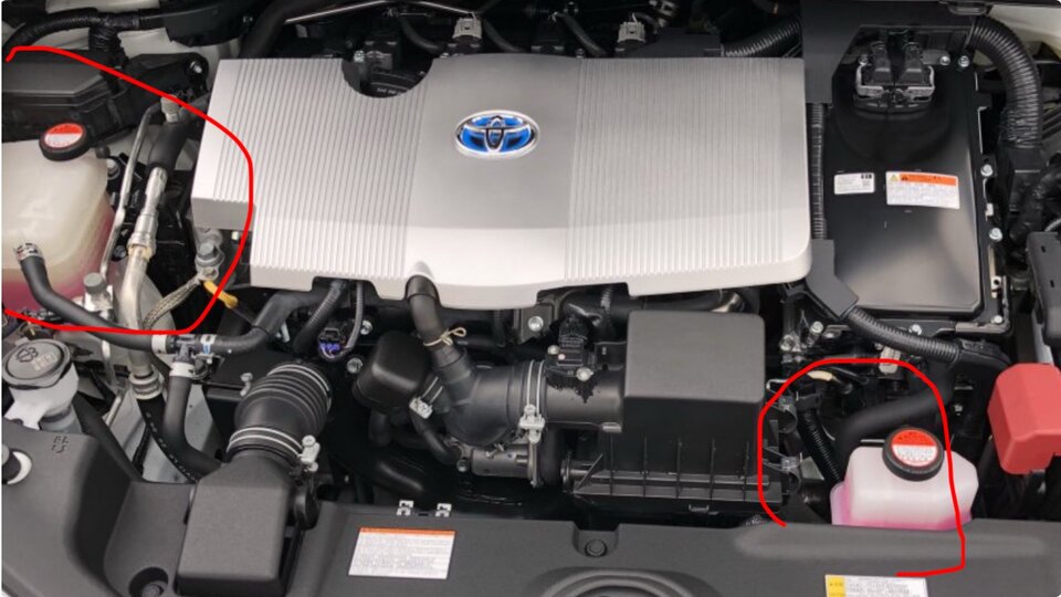

    It's really close to 50k.
    It's right under 50k. I attached a picture of the level it is at.
  14. Mendel Leisk
    61,299
    42,166
    ^thats the inverter fluid reservoir, not engine. The level is only slightly low, not unusual; I would just top up and monitor.
    for reference, right circled is inverter coolant reservoir, left is engine:
    midpitts and bisco like this.

    Oh my bad . Thanks for letting me know. The engine one is fine for now. I noticed that the warranty for the heat exchanger issue only is good for cars less than 8 years old and under 80k miles. Since my car is in the list of cars affected, should I see a Toyota service department to see about getting the new model heat exchanger?
  16. Mendel Leisk
    61,299
    42,166
    First better check the engine coolant. ;)
    Even if it's a tad low, that could be normal. With our 2010 both reservoirs were down to the low line on the reservoir, after about 4~5 years ownership. I topped them both up once, and one, maybe engine, snuck down slightly more. At the 10 year mark I changed coolant on both circuits (per Canadian schedule), and they've been steady since.
    All considered, you likely don't have a problem with yours. I'd score a gallon of the Super Long Life coolant, top both up, and monitor.
    Again, both dealerships and Toyota USA are dragging their feet on this. IF you have a clear-cut case of Exhaust Heat Recovery system leakage, THEN you'd want to go in, with the TSB in hand, and maybe a lawyer on speed-dial. They're oily...

    you lucked out with it being the inverter coolant, and not engine.
