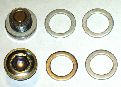

    Just performed the first transaxle ATF change, after 18k miles on the new replacement transaxle on my base 2007 Prius.
    I replaced the OEM oil and transaxle ATF drain plug, w/ Goldplug's super strong (Neodymium) magnetic drain plugs. Goldplug's pitch seems logical: strong magnet to grab floating metalic debris in the fluid (oil/ATF), to minimize further damage from the metalic debris. Guess only time will tell. Looking forward to the next oil and ATF change to see any metalic debris.
    The oil and transaxle drain plug were $15 each, and included one new washer each. Additional washers (which appear to be aluminum and cheap in price) were $.50/each, for either oil or transaxle. Shipping was free since I spent more than $40; unfortunately this promo is over. However, their shipping rates are reasonable. I ordered directly from Goldplug. You can also order from Amazon, but it appears only the oil plug is currently available (checked 2/24/2013). Goldplug has magnetic plugs for other cars and motorcycles too. Supposedly they can custom make a plug for you if you supply them with needed info (bolt thread diameter, thread pitch, etc). Here are the part numbers for those interested:
    Oil drain plug part# AP-03 / oil plug washer part# SW-03
    Transaxle drain plug part# AP-05 / transaxle plug washer part# SW-05
    The replacement plugs can hold a lot of weight. Oil drain plug is shown holding 13.1 oz (3/8" ratchet and 14mm socket), and maintains the same 14mm socket head. The transaxle drain plug is holding 1 lb 7.0 oz (1/2" ratchet), and looses the 10mm hex key for a 1" socket head (thats the biggest socket I had that fit well, but I think 1" would be equivalent to a 25mm socket). The OEM transaxle drain plug could barely support the 10mm hex key socket (1.9 oz).

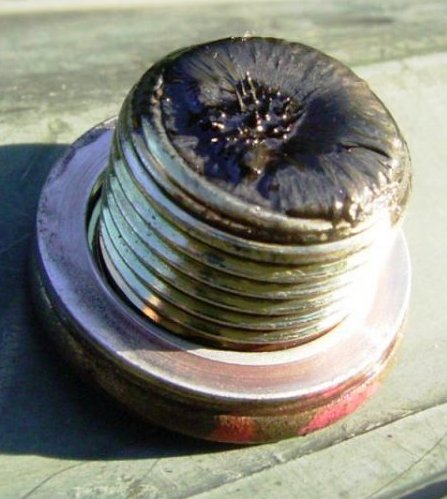

    For those who are currious, here's an update of the Goldplug transaxle drain plug w/ all kinds of metallic debris on it, posted in the Gen3 section.
    Anyone, or a dealer, who says transaxle drain/fill not required would be pressed to refute the visual evidence and the empirical study conducted by Bob Wilson and Prof Denenberg on transaxle ATF-WS wear analysis.
    Post #473; ATF fluid changes ARE Required. | Page 24 | PriusChat

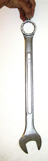

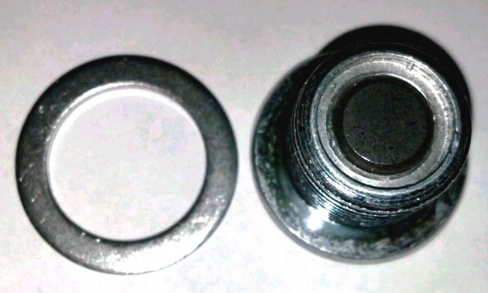

    NEW development...neodymium "rare earth" OEM type drain plug kit.
    If Toyota supplied one, this is HOW they would make it.
    No need for an odd size hex socket to install and remove my new magnetic plug. This plug is made from a GENUINE OEM Toyota Prius transaxle drain plug.
    I took an OE plug and milled it out to take a special extra high strength N51 neodymium button magnet and secured it with JB Weld standard slow hardening epoxy steel, which is stronger than the Qwik Weld type. It when then baked in an oven for an hour to fully harden.
    I've attached photos of my new type holding a 1-1/2 inch combination wrench suspended, a Gen II "small ceramic plug removed during a fluid change and a NEW Gen II plug showing the small ceramic magnet.
    If you have Gen III with NO magnet, this would definitely be an essential upgrade.
