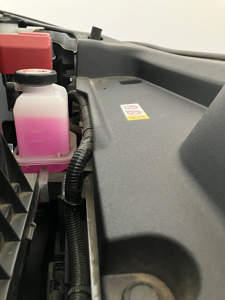

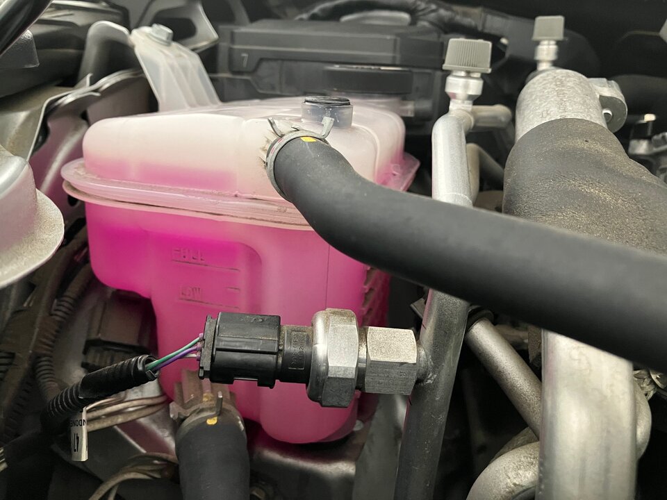

    I finally got another shop to look at the transmission fluid today. It was surprising how many shops thought there was no way to tell if the fluid was replaced recently or just wouldn't inspect it without doing the full transmission fluid service. This new shop said the fluid looked really good, not brand new, but consistent with fluid that was filled 19,000 miles ago.
    Unfortunately this new hybrid shop significantly overfilled my coolant when doing and engine and inverter coolant exchange. They did a coolant exchange on my Prius C a few months ago and filled it slightly above the full line, but this time it wasn't even close. See pictures below. There was also a little coolant outside the reservoir and oil residue on a couple parts near the engine oil cap (they did an oil change too). At least the oil level was good. After I drove home, the coolant level remained the same. Guess I am going to get out the turkey baster tomorrow morning. The owner was friendly and very knowledgeable about Prii. I wished his technicians paid a little more attention to detail, as I really appreciated the owner's honesty. Now I have to decide which, if either of the two shops to return to for future work. I'm leaning towards going back to the previous shop now that I know they actually did do the transmission drain and fill.

  18. bisco
    115,498
    52,878
    i would go to the shop with the most reasonable people, inspect everything before leaving, and ask them to correct anything out of spec.
