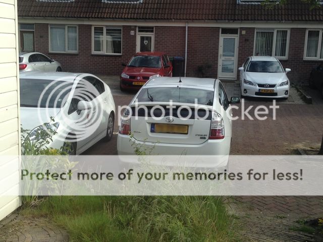

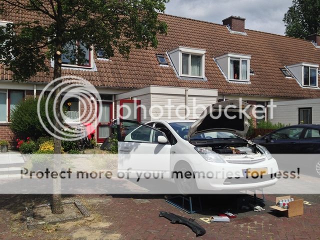

    The view as I pulled up to collect it from the seller's house:

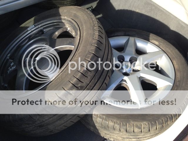

    It was shod with winter tyres so I jumped online and found a set of wheels with summer tyres for €280. The winters are in my shed waiting for what little real winter we have here.

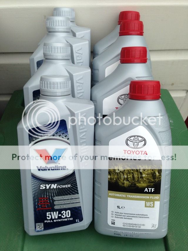

    Unsure of the maintenance details so I bought these:

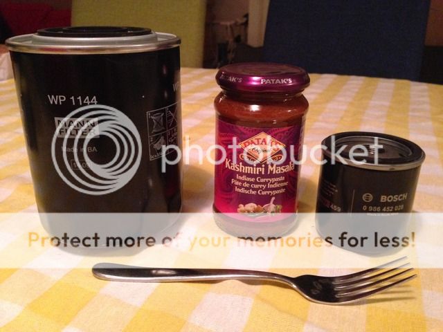

    Oil filter on these things is soooo small, here it is compared to the one from my Fiat Ducato based motorhome:

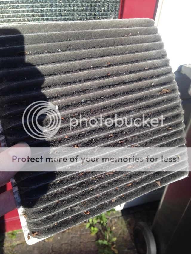

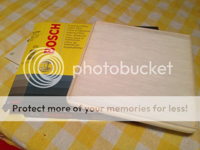

    Cabin filter, current one is gross:

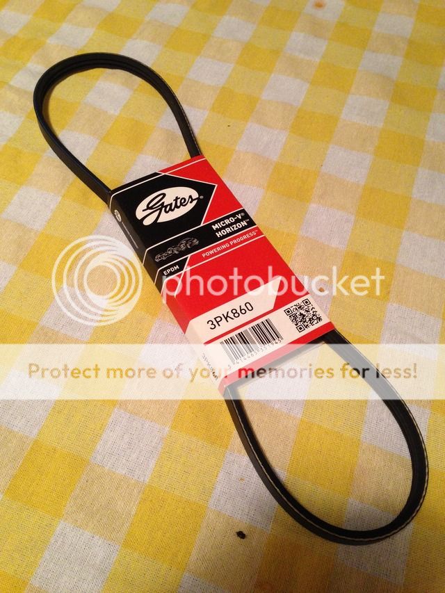

    THE engine belt. I'm still a bit amazed that this car only has one small thin belt!

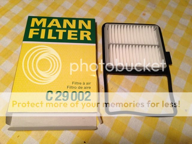

    Engine air filter - current one is "ok" but no more no less so I'll change it anyway:

    Changed the cabin filter, old one looks ancient! Sorry if you're having dinner...

    don't forget the spark plugs,I thought the same about the oil filter, my riding mower is slightly larger..hard to find a wrench to fit it..i use large pliers and curse a lot..seems to work..check the area where the 12 volt battery is for water..most gen 2's leak into that area

    I suggest you purchase a stamped steel cap wrench from your local discount auto parts store - or Walmart which should have a suitable size in stock. Bring along a new oil filter so you can satisfy yourself the cap wrench properly fits. The cap wrench will require a 3/8" extension and 3/8" socket wrench to turn it.

    I did and the smallest one didn't fit at wal mart..i have found them on e bay with an insert to reduce the size but I don't feel its worth 18 bucks...some of these oil change places seem to put the filter on with an impact gun

    Is there a larger filter from another Toyota which fits the Prius engine and is perhaps easier on which to use a 'normal' filter strap/wrench?

    I use the correct Toyota oil filter, 90915-YZZF2, and just bought the Fram FM101 filter wrench from my local Walmart. The size is 65 and 67 mm. If your store does not carry that, look online.
    Fram Oil Filter Cap Wrench, FM 101 - Walmart.com
    Well, some owners use a longer oil filter than 90915-YZZF2 because they want to run more oil in the system, and that might be easier to remove - but I think it would be easier simply to utilize a good cap wrench, and I provided one example above. See what is available in your country. You need a cap wrench with 14 flutes, 65 - 67 mm size. Use a stamped steel wrench, not one made of plastic.

    FWIW the smallest of the 4 graduated oil filter removal caps at Harbor Freight works like a champ for the dinky stock oil filter.

    harbor freight oil filter pliers work fine and they're cheap. you got to crush the filter a little bit. and don't forget to oil the gasket on the new filter.

    Today I changed the transmission oil, engine oil, engine oil filter and water pump belt. All really easy jobs, so far the Prius is a joy to work on. Nothing awkward, seized, snapped, broken or bodged. Weather was warm but not hot or sunny, a slight breeze and almost perfect for working on the car outside.
    Got her up on the ramps, pulled some tools out of the shed and got to work one job at a time.

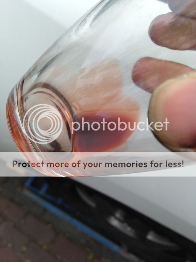

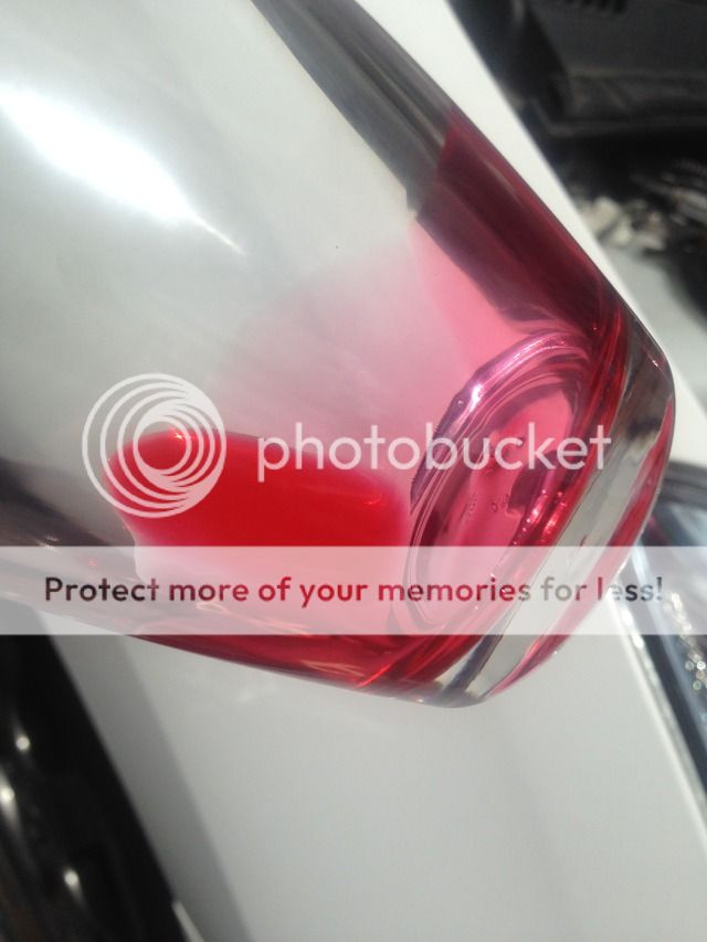

    First up, transmission fluid. All went to plan, this is a sample of what came out. Not terrible (I was expecting black sticky toffee) but has clearly been in there a while. The magnetic drain plug had a fair amount of debris stuck to it.
    And as a lot of you guys probably know, this is what the new fresh stuff looks like.

    We talked about what to use to remove these tiny oil filters - the metal strap thingy I use worked fine on its smallest setting:

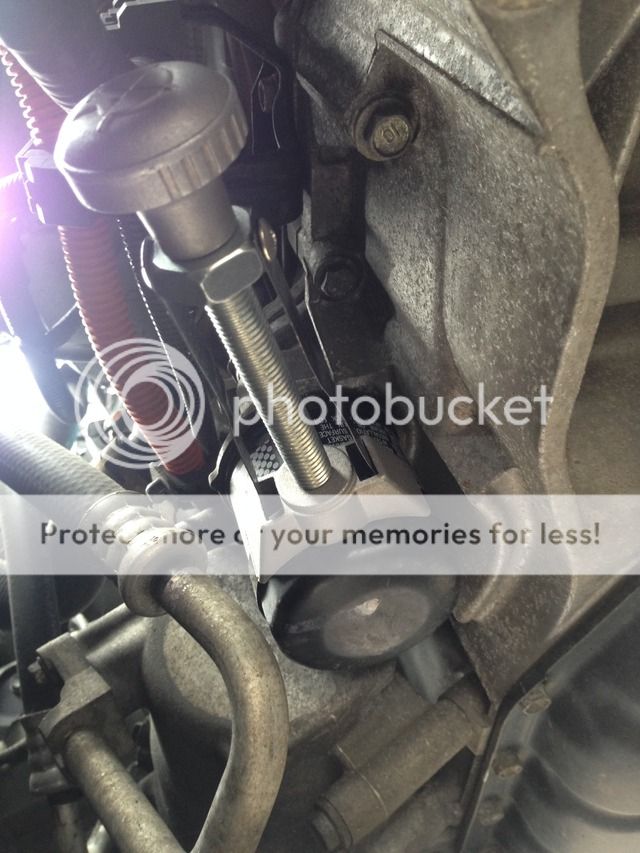

    Last job was the water pump belt. This was very easy except for the pulley bolt which needed an extender bar because the bolt/stud were a bit corroded. Some WD40 and elbow grease loosened it off. Here's the old one - again a tad overdue (!)

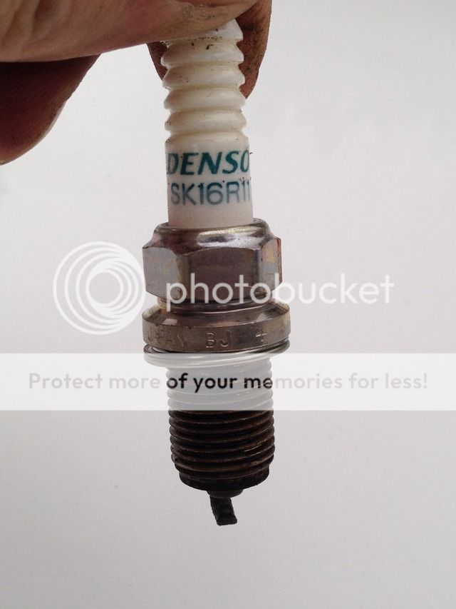

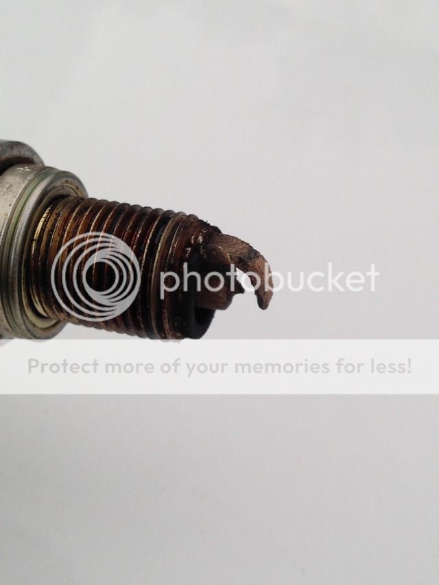

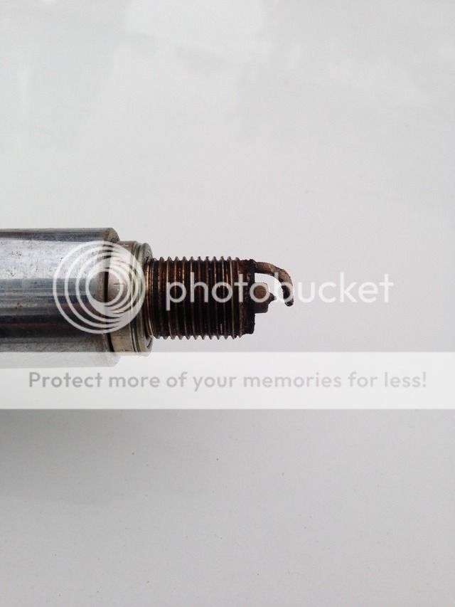

    This evening I pulled 3 of the 4 spark plugs and found this on all of them:
    Looking pretty good and the correct type. I'll keep searching for a sensibly priced new ones but having seen these ones I'm not making it a priority.
  19. Patrick Wong
    Patrick Wong DIY Enthusiast
    Mar 8, 2008
    18,210
    6,517
    Green Valley, AZ
    Did you measure the gap on the used plugs?
    What happened to the fourth spark plug?
    In case you are wondering, the reason the original equipment spark plugs have a 120K mile service life is that the ground electrode has a platinum tip, in addition to the iridium tip on the center electrode. "Regular" iridium plugs lack that platinum tip on the ground electrode.

    Gap not measured because I don't have any feeler gauges yet.
    Nothing at all happened to the 4th one because the dinner bell rang. It was taking longer to remove because of the short wiring to the igniter/coil so I left it alone.
    120k service life, hmm. I cannot tell if these plugs are the original ones but the car is past that mileage at almost 207,000km ( ~ 128,000 miles) so perhaps I should prioritise a plug change.
