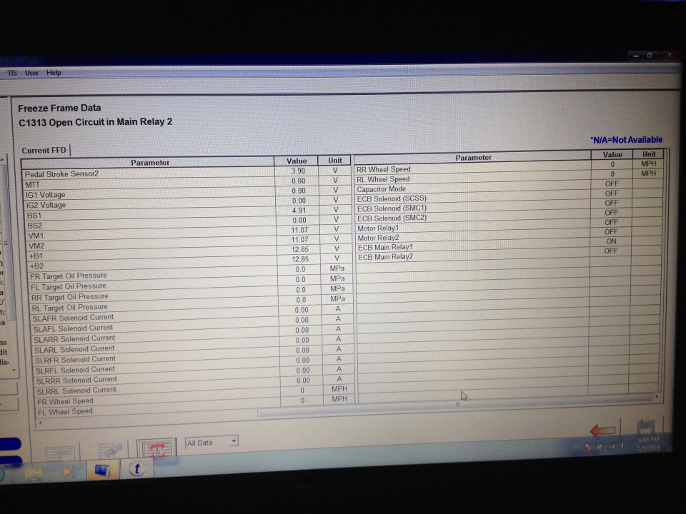

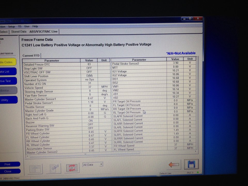

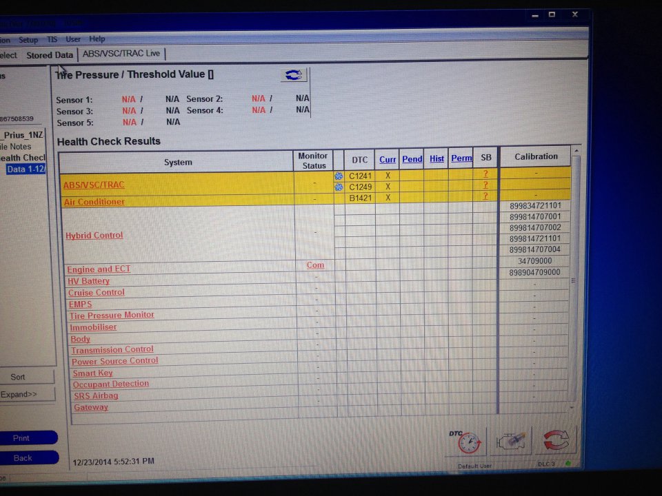

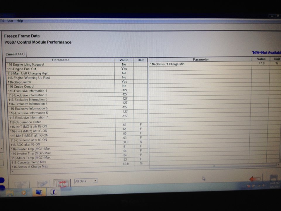

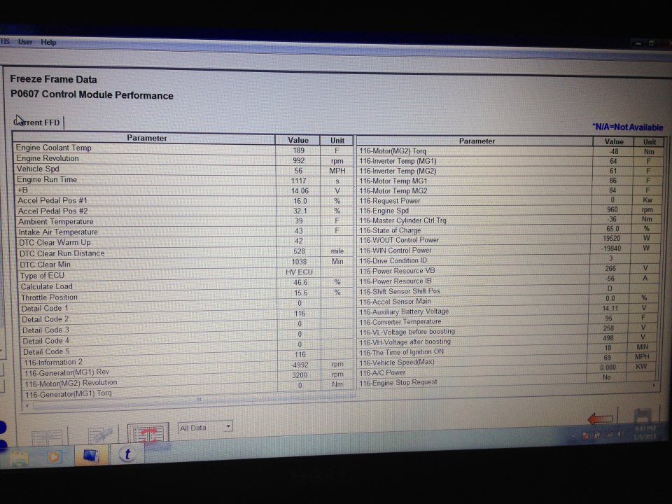

    Tonight she was stopped and lights showed back up as before but without the big red triangle. I pulled the codes and this is what I found.
    As always help is greatly appreciated. I need a reliable vehicle, I half thinking about trading in on a prius v if this keeps up.

    Regarding DTC C1241, check the ABS 1 and ABS 2 relays. "Check" means that you find and remove the relays, one at a time. Use an ohmmeter to identify the relay coil terminals, the resistance will be ~100 ohms or so. Apply 12VDC to the relay coil terminals. Measure resistance across the switched terminals when the relay is energized. If the resistance is more than 0.5 ohm (after accounting for test lead resistance) then replace the relay.
    If the relays are good, was the car in a rear-end accident that would have damaged the brake power supply (the large black rectangular box located next to the 12V battery) or its wiring harness?
    If you don't find an obvious problem and wish to continue the DIY process, I suggest you subscribe to techinfo.toyota.com so you can follow the troubleshooting tree which involves measuring voltage at the brake power supply, verifying the wiring harness, etc.

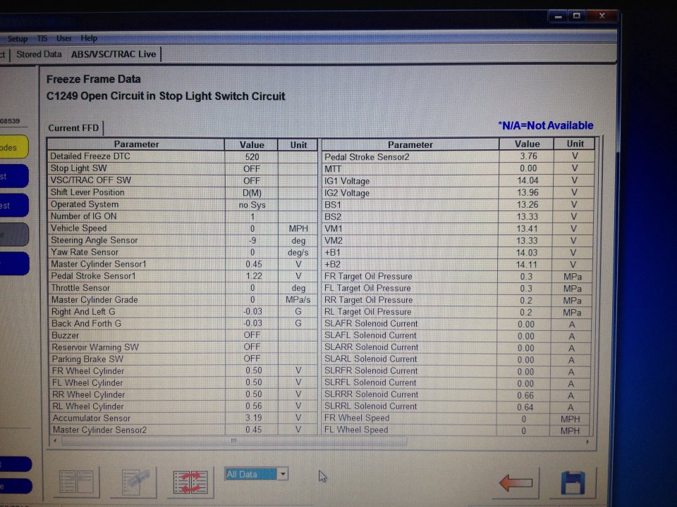

    Regarding DTC C1249, that indicates a problem with the brake light switch, the wiring harness, or the brake light LEDs. When you depress the brake pedal, do the brake lights work?

    Why would the c1241 be a relay considering it says low or high battery voltage? I'm willing to check anything but I like to understand the reasoning behind checking something. The car hasn't been involved in an accident so that's unlikely and both brake and tail lights are working. It seems like once this thing hit 190k and the 12v battery started going bad its been a problem. I'm gonna look at the tech site now. I like to do my own maintenance as I really don't trust most mechanics to work on my cars, boats and airplanes.
    I am also wondering if the c1241 may be a residual code from when I changed the battery? I'm not sure if I ever cleared them after the tow home. I'm thinking so but the only reason I don't know is because it states the speed as 37mph. She was sopped at a light when the dash lights came on tonight which shows on on c1249. The only other thing I wonder is if it could throw the c1241 and not actually show that its thrown one.

    DTC C1241 is logged by the skid control ECU. That DTC means that there is abnormally low battery voltage present at that ECU.
    The ECU receives voltage via the ABS 1 and ABS 2 relays, hence it is necessary to verify proper functioning of those two relays.
    The minimal techinfo package, $15 for two business days, will provide access to the repair manual info you will need. I suggest you do a search in the repair manual text for the DTC logged by your car. Also look at the electrical wiring diagram for the skid control ECU so you can develop a full understanding of the issue.
    You can try clearing the DTC to see if they will return or not. However since you reported that the warning lights appeared only after a period of time had elapsed, then the DTC are likely the result of a current problem.

    The DTC is logged by the skid control ECU because the 12V bus is measuring low as viewed by that ECU.
    So the question is, why is the voltage low? It could be due to several reasons: the ABS 1 and ABS 2 relays, the brake power supply which is the black rectangular box near the 12V battery, the wiring harness that feeds the skid control ECU, or the ECU itself.

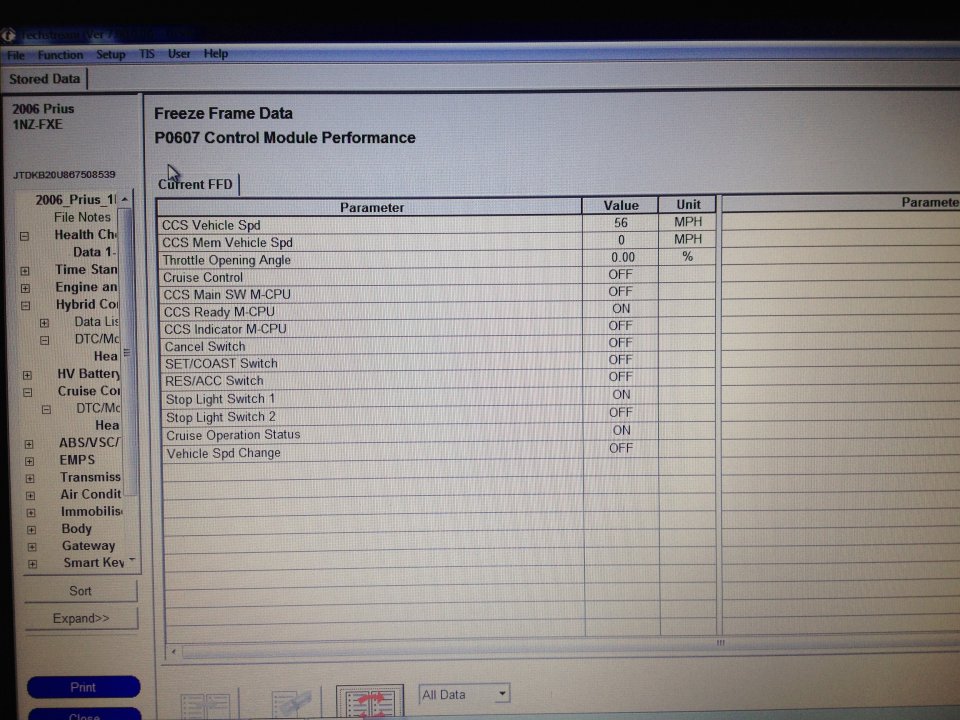

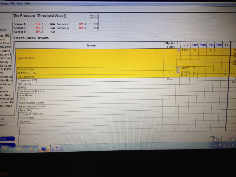

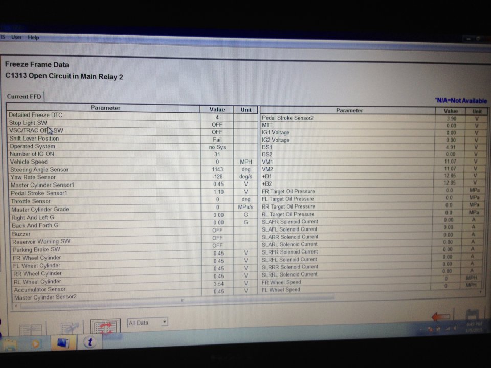

    Well I spoke too soon but this time the codes are different (though it flashed the cruise before but not since changing battery). The wife had been using the cruise for about 5 minutes; she pulled to a stop light and the cruise light started flashing. I am at a loss with this thing :( .
    Any ideas what the problem may be now? I am going to get on Toyota tech but with so many codes I feel like I will be chasing my tail.
