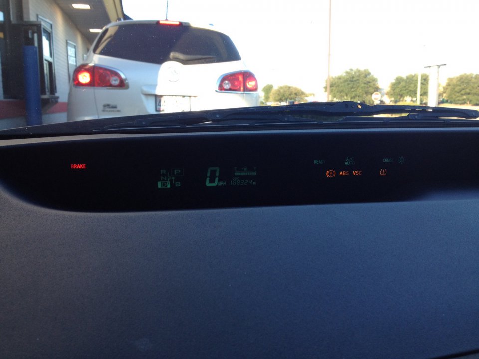

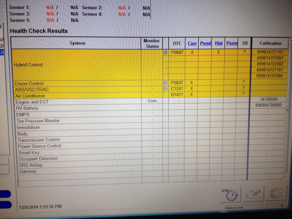

    Well I finally got my tech stream to work and was able to get my codes. My wife was driving and she had a bunch of dash lights come on. I pulled the codes and this is what I found.
    Can't get the pic to load.
    The AC auto light, tire pressure and cruise was already on. The others come on with the beeper on constant.
  4. bisco
    115,319
    52,779
    how is the 12 volt battery?
  5. av8erdunn
    av8erdunn Junior Member
    Oct 16, 2014
    78
    Mobile AL
    I haven't ever changed it and I have had the car for two years at the end of this month. All of this happened while in the drive thru. She has to shut the car off then turn it back on and all is fine. Its happened three times over the past few months.
  6. bisco
    115,319
    52,779
    could be on the edge. i would either test it or replace it.
  7. av8erdunn
    Oct 16, 2014
    78
    Mobile AL
    Would that cause codes like that?
  8. 69shovlhed
    69shovlhed Surly tree hugger
    May 13, 2012
    2,170
    752
    Delaware
    weak 12v causes all kinds of weird stuff. if its 8 years old, its probably weak
  9. bisco
    115,319
    52,779
    if it's not the 12 volt, it could be an ecm, transaxle, trouble.

    Read Post #11 that Patrick Wong wrote up

    i'd check the battery, brake fluid level, etc, first.

    Did this same fault occur three times at the drive in? If it did what state was the car in when it occurred. Ready in park, ready in neutral, or accessory mode? "Two pushes of the start button without touching the brake . Or just one push of the start button "no brake".

    No, it has happened three times over the course of a few months to my wife. It was in drive mode every time; I know it has happened while she was accelerating from a stop light twice but the third time I am not sure if she was accelerating in line at the drive thru or was sitting still when it happened. This is the only time an audible alarm has accompanied the lights though.

    Update... it finally died and had to be towed home a week and a half ago. 12v battery would drop below 10v and would basically shut the car down. I replaced it with a yellow top optima and all was well until tonight. I have started a new thread detailing the new codes. Sorry for the late update but with Christmas its been hectic.
